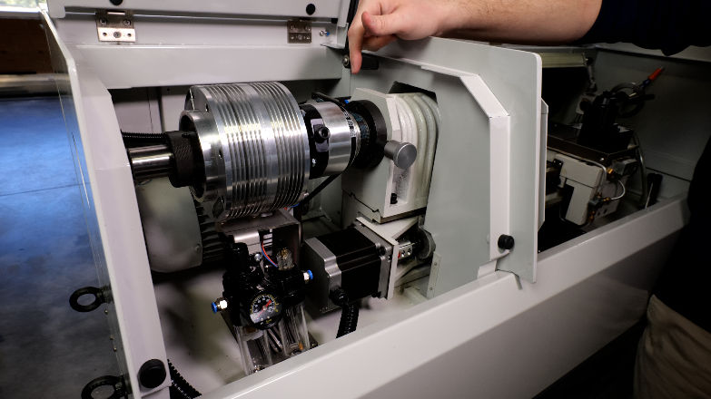

Designed exclusively for the 8L Lathe, the Automatic Collet Closer provides air-actuated clamping for standard 5C collets and integrates with Tormach’s PathPilot control system. Clamping force is controlled by regulating input air pressure, allowing users to achieve repeatable, adjustable part retention without the need for manual drawtube operation. The system is manufactured in the U.S. and offers optional foot pedal actuation for added operator control and faster hands-free operation.
The addition expands the capabilities of the 8L Lathe, a compact CNC-ready platform designed for prototyping, short-run production and toolroom work. Built to bring professional-grade turning capabilities to small shops, educational environments and product development teams, the 8L combines precision, ease of use and broad tooling compatibility in a machine that operates on standard single-phase power.
“Customers will be most excited about how much faster part and collet changes become with the Automatic Collet Closer,” said Reid Halvorsen, mechanical design technician at Tormach. “Adjustable air pressure at the FRL gives users precise control over clamping force, making it easy to securely hold everything from standard parts to thin-walled or delicate components.”
By eliminating manual tightening, the system helps reduce repetitive operator tasks while improving consistency across runs, particularly in applications requiring frequent part swaps, small-batch production or careful handling of delicate materials. The air-actuated design also enables more repeatable setups, helping machinists maintain part quality while reducing downtime between operations.
“This has been one of the most requested accessories for the 8L, and for good reason,” said Max Sample, technical presales advisor at Tormach. “The Automatic Collet Closer saves time and simplifies daily operation by removing the need to manually tighten the drawtube. With air-actuated 5C collet clamping, loading and unloading parts is faster, easier and more consistent.”
