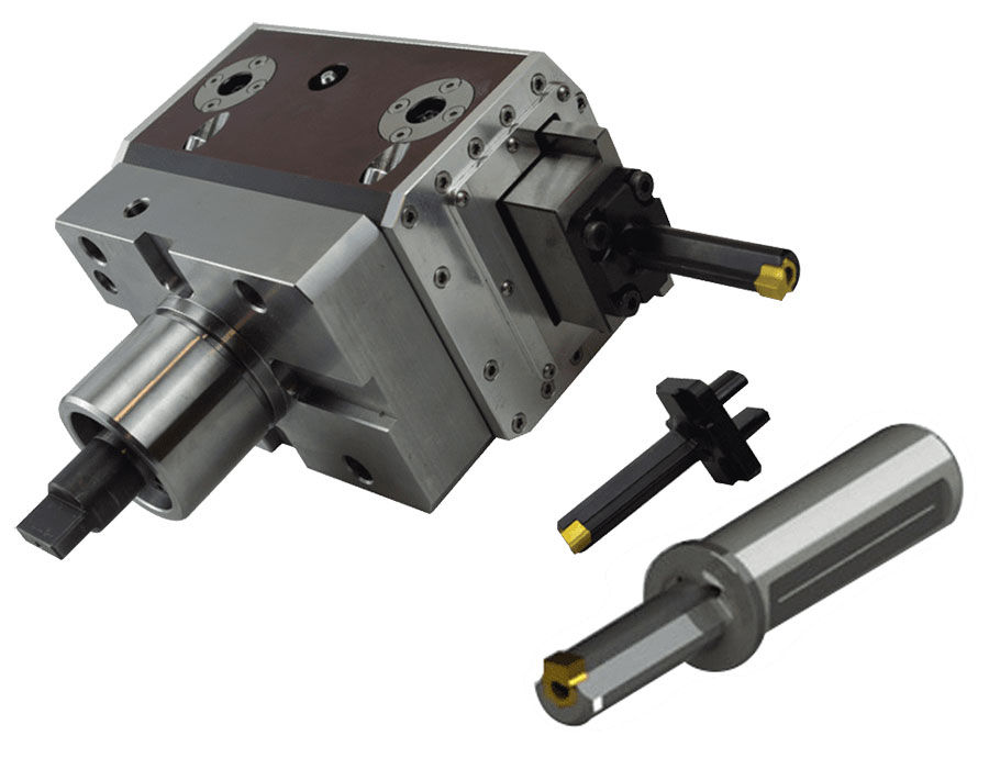

duMONT-CNC.pngduMONT CNC Broaching System
Courtesy of Pilot Precision Products

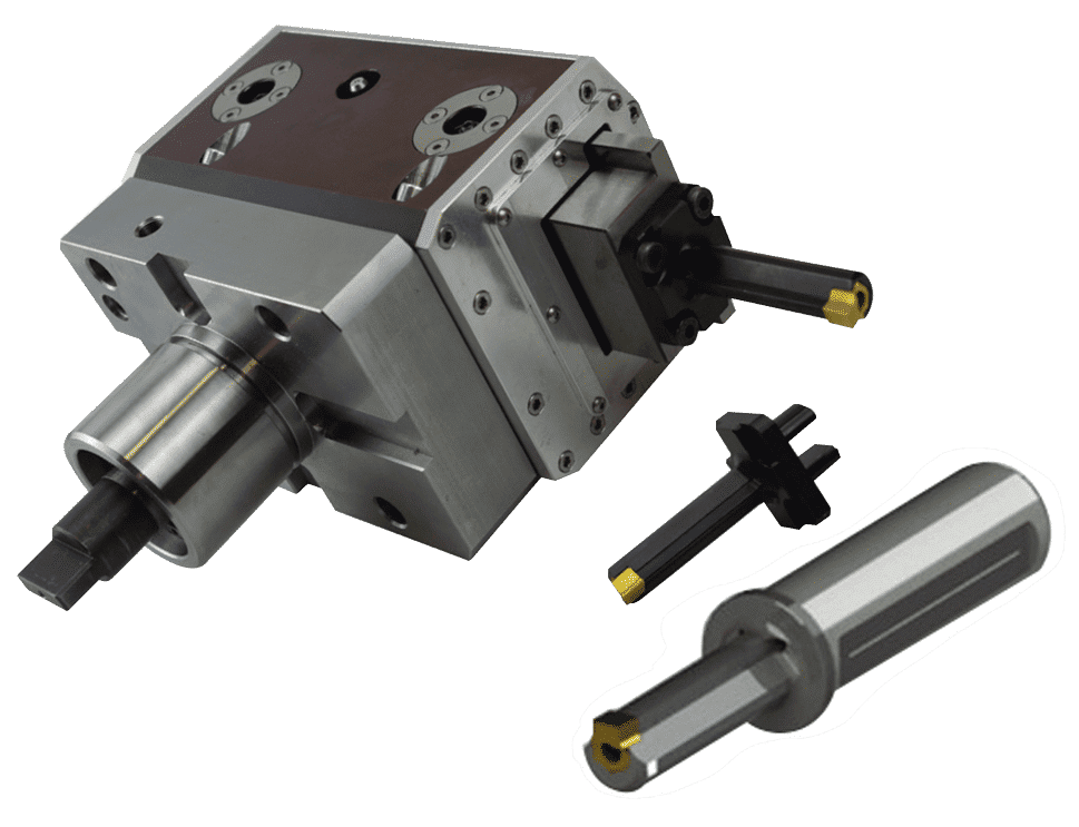

Picture1.pngCourtesy of CNC Broach Tools
Broach tools for CNCs can be mounted static to the turret face or to a live motorized-slotter accessory that attaches to the side of the turret with live tool capability. Making the right choice for an application depends primarily on complexity — the number of keyways, teeth, etc. — and the quantities one needs to produce. With smaller runs (up to around a few  hundred pieces per month), the static tools are cost-effective. If the run is over several thousand per month, a live broaching tool is a faster, less expensive solution.
Depending on the design, however, a static tool has a greater machine length capability than a live tool, but depending on the material, there is a potential risk for deflection. According to Morgado, “The biggest thing customers have to keep in mind is how much load is being generated in the cut based on the tool recommendation that goes with it. With our products, when we tell you a ¼" keyway insert will go in a #6 holder, it’s because of the optimal rigidity of the #6 holder to minimize deflection in the cut. In broaching, that’s what you have to manage is deflection.”
Pilot Precision Products inserts are standard in stock for inch & metric keyway widths and standard broaching tolerances from H7, P9, D10, C11 and with end chamfer, square, and hex shaping. Spline inserts are custom made in various alloys, geometries, sizes and tolerances and are attached to the insert holder with a set screw. The insert holder, usually with a shaft diameter of 1" or 1¼", is then clamped to a boring bar holder or a VDI boring bar holder with a corresponding diameter on the CNC lathe. For use on machining centers, the holder can be clamped with any tool holder with a cylindrical holder, such as a collet chuck or Weldon holder.
By pushing the insert into the workpiece, the keyway or spline is machined step by step. The cutting speed and the cutting depth must be set depending on the workpiece material. Gardner says, “Ongoing education of the machinist is really a large aspect of what we do here.” Catalog values mostly serve as approximate values and that programming adapted to various factors on site (e.g., room temperature, machine type, machine condition, workpiece quality, coolant) can produce optimal machining results.
Live broaching tools are worthwhile for large quantities and provide cost-efficient production of different geometries. They are a low investment relative to purchasing a separate broaching machine with competitive processing (up to 400­ – 800 strokes per minute). Depending on the material being cut, general speeds and feeds for keyway slotting are .0005" – .0015" per pass at 250 – 550 IPM.
