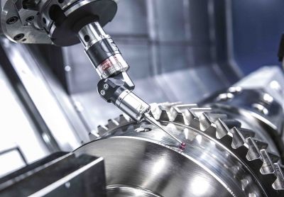

Measuring strategies for the measurement of gears replace manual measurements by machine operators. The correction for the tool is determined automatically. This measurement process is essential for reliable gear machining and can be simulated with WFL's programming and simulation software CrashGuard Studio.

Thanks to the possibility of scanning profiles and evaluating the results, WFL has developed cycles especially for gearing technology, which, for example, allow measuring the flank profile or the tooth trace. Afterwards, the measurements are evaluated. The evaluations and protocols correspond to the general industry standard for gearing technology. Gearings can thus be checked and recorded after the machining process in accordance with industry standards.
