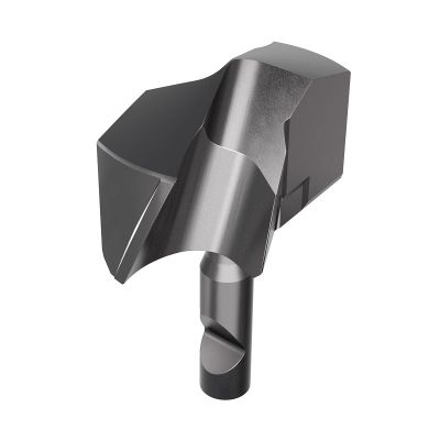

WIDIA has announced the release of a new MS geometry insert for the brand’s TOP DRILL Modular X (TDMX) drill. With the MS geometry expansion, the TDMX platform now offers three material-specific inserts, broadening the platform’s
application capabilities to include inclined entry and exit, stacked plates and cross-hole drilling in stainless steel, super alloys, steel and cast iron materials.
“The launch of the MS geometry insert for our TDMX portfolio gives customers a versatile tool for multiple workpiece materials and applications,” said Ashokkumar D., WIDIA global portfolio manager. “This new MS geometry is designed to perform in different types of stainless steels and super alloys making it an ideal choice for customers looking for excellent stability and reliability in general engineering and energy machining operations.”
In a recent customer test, the TDMX body, paired with the new MS geometry insert, achieved a 60 percent increase in tool life versus competing solutions while machining a 13-8 Hyper Chrome 110 KSI workpiece material at 3XD with a cutting speed of 75m/min.
