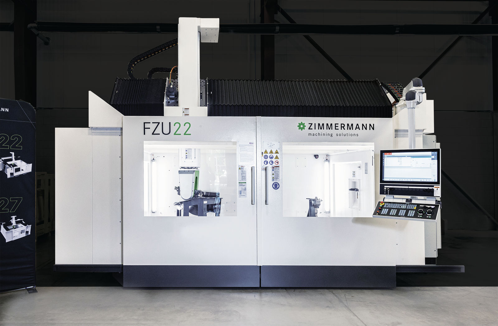

Zimmermann will feature a 5-axis portal milling machine for lighter weight machining applications aimed at large structures at Booth #339336.
With FZU22, Zimmermann adds a machine that’s capable of machining various workpiece shapes, sizes, and materials. Aluminum, plastic, wood and other substrates can be processed, as well as finishing carbon fiber reinforced and other composite materials. The overhead gantry provides precise production of models and molded parts. A standard machine includes a tool changer for 24 tools and a CNC from Siemens or Heidenhain for full motion control and tracking, while a specially developed 5-axis milling head with a 15 kW spindle can mill complex contours and tight pockets in large molds.
The FZU22 boasts a substantial working range, from 71" to 98" in the X-axis, 118" to 138" in the Y-axis, and 49" in the Z-axis. A feed rate of 2,756ipm in the X- and Y-axes is standard while the acceleration on the machine is max. 118 in/sec2 to 197in/sec2. With a compact footprint of 11ft x 15ft, the machine fits in any small space available in a shop with minimal foundation requirements. ISO 230-2 accuracy is provided. A choice of milling heads is offered on the machine to suit a variety of applications.
Optional equipment includes touch probe, tool measuring system, work area cover, tool changer, chip conveyor, mist/dust extraction system, minimum quantity lubrication and a vacuum system. The machine to be displayed at IMTS also features an ultrasonic system for cutting aerospace insulation.
