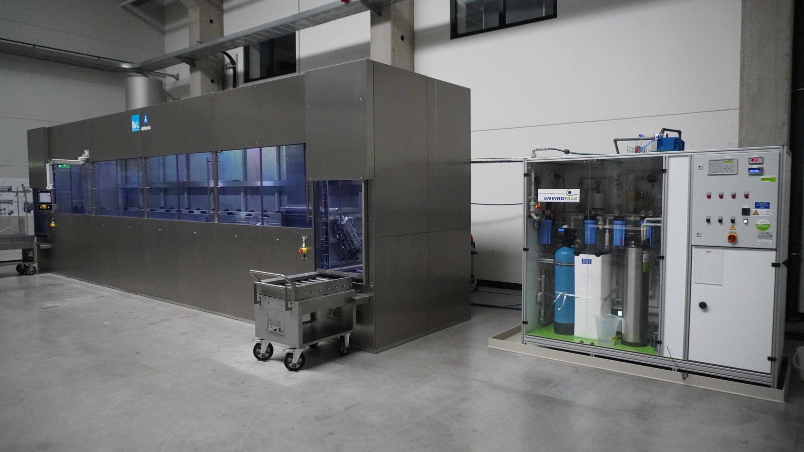

During rinsing, it is decided whether high-purity components reach the required cleanliness limits or whether recontamination after cleaning leads to scrap. Three factors are particularly critical: ultra-pure water quality directly at the point of use (particles, organics/TOC, conductivity, pH); minimal carryover between process stages and a clearly defined rinsing strategy; and plant engineering and loop hygiene (suitable materials, well-designed piping and continuous monitoring).

This is where sophisticated plant engineering is required. It must ensure excellent water quality at the point of use through minimal carryover, appropriate materials and effective loop hygiene. Rinse quality is only as good as the system that carries it.
From the outset, the cleaning system must be designed to minimize carryover. This includes strict separation of media circuits. Each tank has its own piping, filter units and pump. Piping runs should be flow-optimized to prevent residual water from collecting anywhere.
Workpiece carries and racks must be designed to avoid scooping points and unnecessary surface areas where water residues can remain.
In transfer immersion systems, defined overflows and separation baffles between tanks are important. Drip times and vibration of carriers support carryover prevention. In chamber systems, a drain-optimized chamber design, complete draining and chamber cleaning between treatment steps are beneficial.
Water quality should be monitored directly in the cleaning system, at the point of use, using appropriate sensor technology.
Due to improved compatibility, V4A stainless steels (e.g., 1.4404, 1.4571) should be used instead of V2A. Weld quality must be ensured. Brass should be avoided entirely. PP and PVDF may also be suitable for piping, depending on the application.
