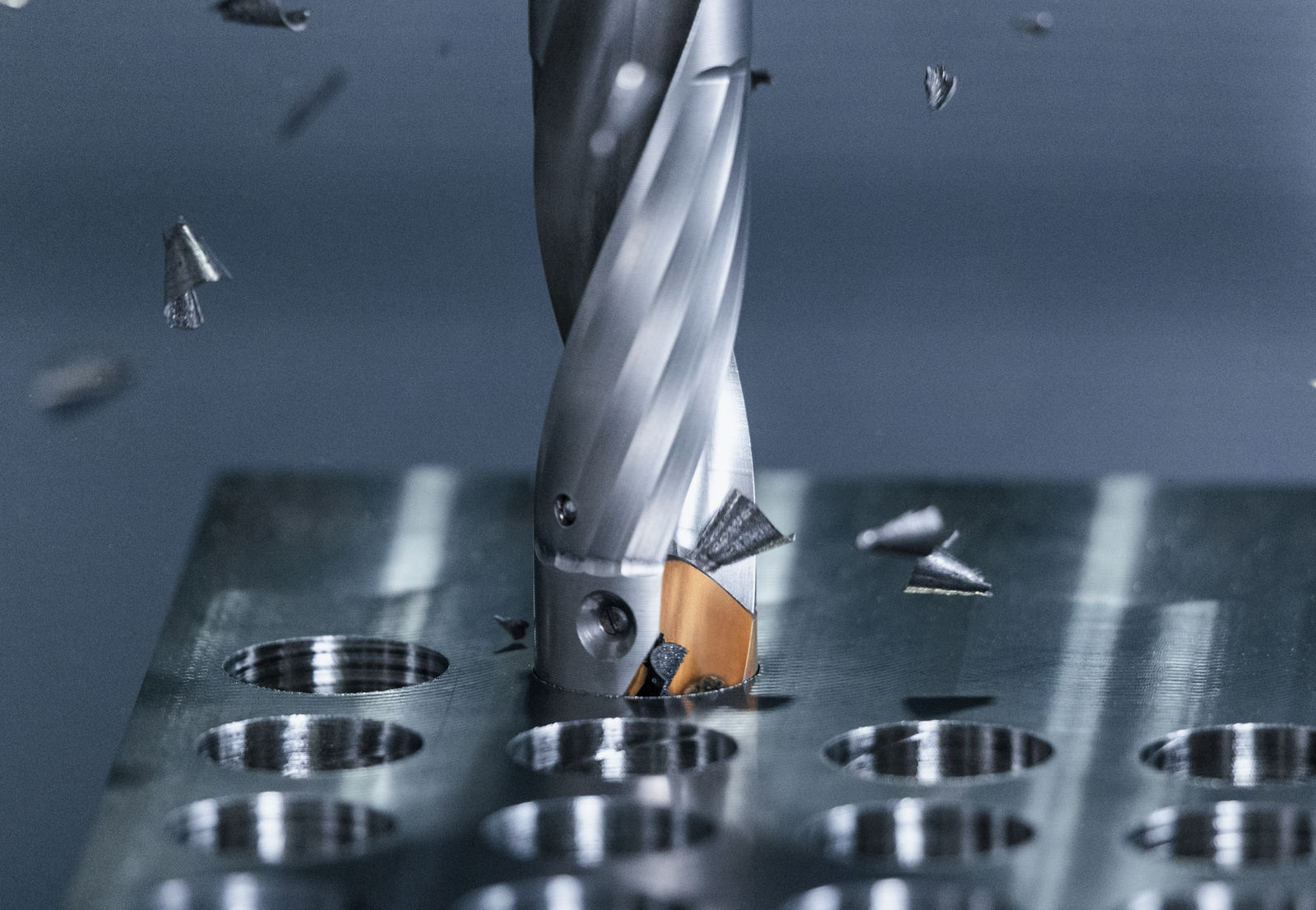

Change drills for cost-savings and sustainability
