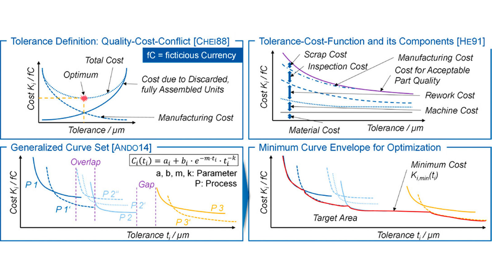

Figure 1—Quality-cost conflict, tolerance-cost function with its components and derivation of minimum costs according to Refs. 8–10.
For a generalized cost-tolerance description of the individual processes, He presents analytical approaches based on exponential functions and parameterizes these using a survey. He uses the developed correlations as a criterion for a generalized tolerance design. He compiles the costs for an acceptable workpiece property from individual cost items. The machine costs are only a subordinate part of this, see Figure 1, top right (Ref. 9).
Existing cost-tolerance modelling covers a wide range in addition to the actual production, which was described by Andolfatto et al. with a generalized formula for the individual costs Ci with hyperbolic, exponential and linear components, see Figure 1, bottom left (Ref. 10). The C-T functions of a manufacturing process should fulfil three conditions, which are in Equations 1–3.

The relationship between a manufacturing process and the appropriate analytical description model is not always clear. Sanz-Lobera et al., therefore, present an alternative approach for determining a cost-tolerance relationship using measurement data and the assumed scatter shape of a geometric feature. He comes to the realization that the scatter shape has an important influence on the cost-tolerance function and presents equations for some distributions (Ref. 11).

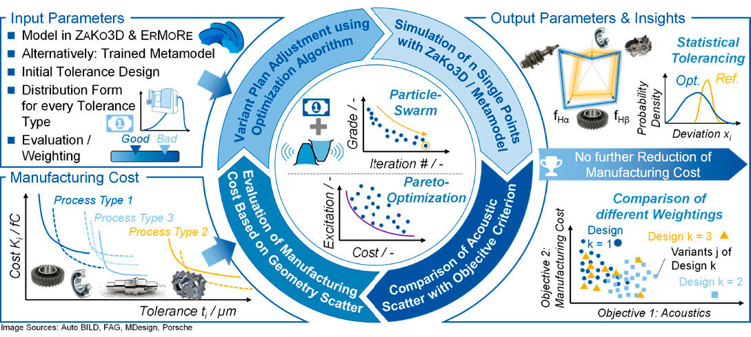

Figure 3—Input and output variables and schematic sequence of the design method.

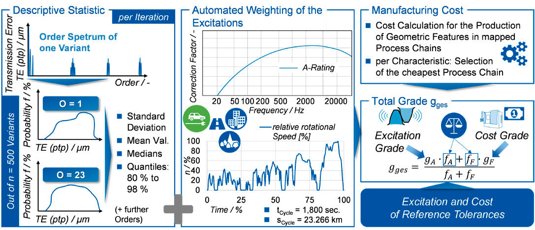

To achieve this design objective, the calculation method iteratively generates a variant plan. Each variant contains a freely definable number n of simulations of virtual overall gearboxes whose geometric scattering corresponds to the previously defined distribution shapes. The excitation behavior is afterwards calculated from the n individual points, see Figure 3 in the center.
Each iteration is then checked for fulfilment of the acoustic target criterion. For this purpose, descriptive statistical characteristic values are determined and evaluated for the variant, consisting of n individual points. These are the mean value, standard deviation and various quantiles for selectable order components of the transmission error. This is explained in detail in the following section. In addition, the manufacturing costs are estimated on the basis of the geometric deviations. Depending on the available process types, individual functions are parameterized for each geometric feature, see Figure 3, bottom left.
For each iteration cycle, the optimization procedure is used to adapt the variant plan for the geometry data. In addition to the uniform particle-swarm-optimization (PSO), the use of a multi-criteria PSO Pareto optimization is also investigated. The statistical tolerance specifications, which fulfil the excitation requirements with the lowest possible production costs, are derived from the calculation method, see Figure 3, on the right. Depending on the selected weighting and excitation evaluation, different designs result as solutions.

The design of the excitation behavior based on the total transmission error of a gear pair is often carried out by considering supposed worst-case scenarios in which the limit values of the geometric deviations are mapped. The main disadvantages of this approach are, on the one hand, that the maximum excitations do not necessarily have to occur at minimum or maximum deviation amounts, as different flank and form deviations have different effects on the course of the load-free transmission error and influence each other (Ref. 2). On the other hand, when assuming approximately normally distributed deviations, particularly high deviation amounts occur much less frequently, so that a worst-case consideration is often unsuitable.
For the reasons mentioned, parameters from descriptive statistics are used here to evaluate the excitation. In addition to the mean value, standard deviation, median and RMS value, these are the 80 percent, 85 percent, 90 percent, 95 percent and 98 percent quantiles. The latter determine the maximum values of the total transmission error for the associated probability and can be important quality parameters. Weighting factors can be used to set the aforementioned statistical variables, which are determined per tolerance iteration on n = 200 variants, in a preferred relationship to each other. For the calculations carried out here, all statistical parameters are weighted equally.
In detail, different orders of the total transmission error in the long-wave and short-wave range are analyzed. The rotational orders O = 1, 2, 4 of the pinion and wheel shaft are analyzed. In addition, the first to third gear mesh orders O = 23, 46, 69 (in relation to the pinion) and the neighboring sidebands of these (O = 22, 24, 45, 47, 68, 70 in relation to the pinion) are analyzed. On the one hand, the excitation orders can be set in relation to each other with a manual weighting in order to subsequently determine an overall score for the excitation of a tolerance design.
Another option is to implement an automated determination of the weighting factors. This first determines the frequency of occurrence of the drive speed at the pinion using a time-speed curve, which is taken from the WLTP test cycle for motor vehicles as an example (Ref. 32). This is done in intervals of ΔnPinion = 100 rpm from nPinion = 100…18,000 rpm, which would correspond to the entire speed range up to the maximum speed of the car. The evaluation orders are converted into excitation frequencies along the speed segments with a step size of ΔnPinion = 100 rpm. Each excitation frequency per speed step is then weighted with the A-weighting curve according to ISO 226 (Ref. 33). The value obtained there is furthermore multiplied by the frequency of occurrence of the speed step under observation and then arithmetically averaged over all speed steps. In this way, weighting factors are obtained for each order of transmission error, which depend on the frequency of occurrence of the speed and the A-weighting of the human noise sensing.
Finally, a grade is awarded. A linear evaluation is carried out in the range gA = 1…6 (good to bad). The acoustic grade gA = 1 corresponds to a reduction of the statistical parameter by p = 5 percent compared to a conventionally estimated reference design. The grade gA = 6 means a deterioration of p = +5 percent. Finally, the individual scores are arithmetically averaged to give the overall acoustic score. The reference thus achieves the overall grade gref = 3.5.

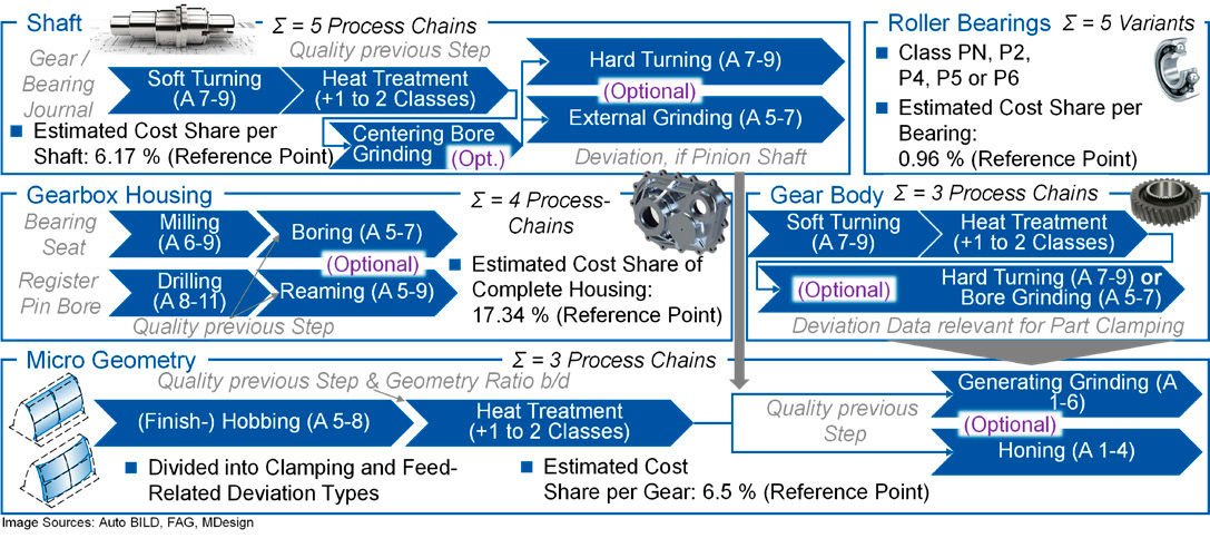

The modeling includes the process combinations shown in Figure 4. For the input and output shafts, the possible variations of soft turning, heat treatment and optional hard turning or external cylindrical grinding treatment are modeled. For the latter, upstream regrinding of the centering bores is simulated as an option, which, based on experience, results in a cost increase of p = +18% in terms of an additional process. The interlinked processes transfer their deviation data to each other. The reason for this is that the effort required to achieve, for example, low concentricity deviations in a subsequent process is significantly greater if the input quality is low due to a poorer turning process. The quality levels are determined from estimates in specialist literature and are an approximation for demonstration (Ref. 34).
Figure 4—Modelled manufacturing process chains, quality variance and estimated cost shares of the components for a 2-stage 1-speed E-cylindrical gearbox for passenger cars.
Figure 4—Modelled manufacturing process chains, quality variance and estimated cost shares of the components for a 2-stage 1-speed E-cylindricalgearbox for passenger cars.
The manufacture of roller bearings as purchased parts is not simulated in individual processes. The simulated dimensions are divided into quality classes in accordance with ISO 492 (Ref. 35). The relative differentiation of procurement costs from the quality class is based on an expert survey of a bearing manufacturer. Compared to the standard quality class PN, this manufacturer sees a relative cost increase ofp = +10 percent for quality class P5 and p = +15 percent for class P4. It should be emphasized that the internal clearance for a standard deep groove ball bearing is not decisive for costs, as the tolerance zone width remains almost constant in the various internal clearance classes and, in principle, only the tolerance zone position of the ball’s changes. Cost increases of p = 3...5 percent are only to be expected for extreme internal clearance classes (C2, C5). Therefore, the influence of the internal clearance with regard to economic optimization is not considered further in the following.

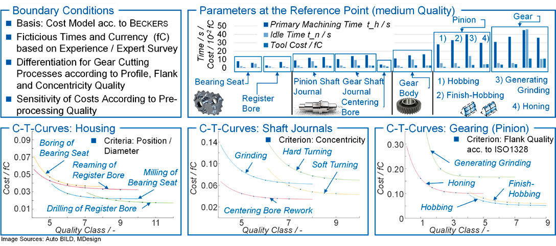

Figure 5, top lists the assumed reference times and tool costs for average qualities for the various processes and geometric features. Their validity assumes that the previous process (hobbing) also fulfils its reference quality (class A 6.5). For turning processes, the values only refer to the finishing of a single feature. The variation for determining the coefficients of the cost-tolerance curves for the features includes the primary process time th, the secondary process time tn and the tool costs KW. Other machine-specific costs such as procurement, depreciation, energy costs, etc. are recognized as non-qualified costs. Energy costs etc. are not considered to be decisive for quality and are kept constant for each process type. The values used correspond to own experience or information from machine manufacturers. The costs are stated in fictious currency (fC).
Figure 5—Process parameters in the reference point for calibrating the C-T curves.
For gear-specific processes, it was taken into account that different machining times and therefore also costs influence geometry parameters such as profile, flank and pitch deviations in various ways. For this reason, different cost-deviation curves (C-T curves) are used for the three deviation groups mentioned, which differ by constant factors for the sake of simplification. In this way, the aim is to map process-specific characteristics. For example, it is assumed for the profile deviations of the honing process that higher tool costs of p = +20 percent are incurred to achieve the same quality class than for flank deviations. The background to this is that the change criterion of the honing ring is the profile deviation. In addition, it is assumed that honing requires p = +40 percent longer idle times due to dressing in order to achieve the same quality level in the pitch deviations as in the profile and flank deviations. The same applies to the primary machining time. The reason for this assumption is that the elimination of pitch deviations on the workpiece or tool is more demanding. The parameterization involves assumptions that should be individually adapted by the user. After setting the reference points of each process concerning its machine times and assumed costs, the C-T curves are parametrized with factors according to the formula of Andolfatto (Ref. 10).
For the primary machining time of gear hobbing and finish hobbing, p = +25 percent longer primary machining times are assumed, which lead to better quality classes due to reductions in the feed marks. For generating grinding, in order to achieve better concentricity through an extended infeed process, a idle time that is p = 20 percent longer is assumed to achieve the same quality class level in concentricity/run-out, based on profile and flank deviations. Therefore, time and cost intervals for the tool are used for the reference quality levels, depending on the type of deviation. The characteristic values can be parameterized in the method and can therefore be individually adapted. Figure 5 below shows the C-T function resulting from the assumptions for various machining operations. These also include the five calibration points per curve. It was possible to approximate the Andolfatto description approach with coefficients of determination R2 > 98 percent for all correlations (Ref. 10). For hard finishing of the gears, it can be seen that the C-T curves can also assume values for qualities A < 1. This purely mathematical, although no quality levels are defined in this area in reality. In addition to the aspect that a tolerance design in these particularly precise qualities quickly becomes unprofitable, the final tolerance design must always be checked for plausibility of the required quality class.

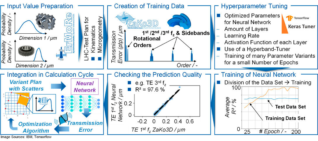

In order to use iterative metaheuristic optimization approaches, it must be possible to determine the excitation and cost parameters quickly in order to obtain a tolerance design with a reasonable amount of time. To increase speed, a meta model is therefore used which, after training with training data generated by a finite element-based tooth contact analysis, determines the total transmission error based on the gear micro geometry and axial position deviations. Figure 7 shows the procedure for creating and integrating such a meta model in the form of a deep neural network (DNN) with TensorFlow Keras based on Python (Ref. 39). After the creation of n = 6,330 training data sets in the FE-based tooth contact analysis, the training parameters are optimized, which takes about t = 2 h. This is done by varying the network parameters. The network is trained for a small number of epochs by varying the network parameters and a suitable parameter set is determined based on the training loss. This includes the number of layers, activation functions, number of neurons, etc. After training, the model is validated and the DNN is integrated into the cycle instead of the finite element-based tooth contact analysis. Figure 7 shows the training process and the prediction result for the transmission error (TE) in the third gear mesh frequency 3rd fz.
Figure 7—Procedure for increasing the performance of the calculation system with a meta model.

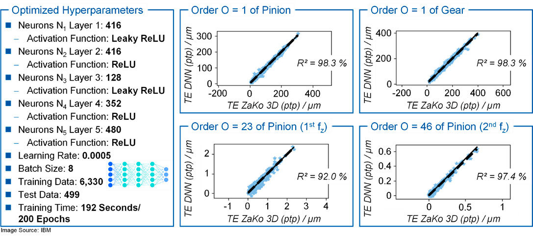

In detail, the optimized parameters were the hyperparameters listed in Figure 8 on the left. With a training effort of t ≈ 192 s, the predictions of the DNN compared to the calculation results from the finite element-based tooth contact analysis are shown for the first rotation order with regard to pinion and wheel as well as the first and second gear mesh order. For validation, n = 499 other variants not included in the training data set were used. The prediction qualities for all orders are R2 >88 percent and are therefore sufficiently suitable for prediction of the acoustic behavior.
Better values were achieved for the rotational orders and their higher harmonics, see Figure 8, top. Isolated sidebands of the gear mesh orders proved to be more difficult to map due to their very low amplitudes and their partly stochastic dependence on modulation effects. The gear mesh frequencies (1st to 3rd fz) are not affected by this, as can be seen Figure 8, bottom. It is relevant for the training data that these are available within wide limits. This was ensured by limits that correspond at least to the factor f = 3 of the reference tolerances.
Figure 8—Training parameters of the DNN and selected prediction results.

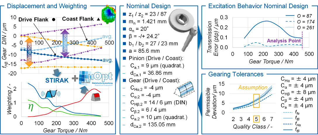

Gearbox and Gear Data
As an example, an e-drive gearbox is used (Ref. 40). It was designed to have similar characteristics as a real series gearbox in terms of geometry, material and stiffness. The first, high-speed cylindrical gear stage is considered. The helix angle deviations due to load-induced deflections at the gear shown in Figure 9, top left, are obtained, which were integrated into the FE-based tooth contact analysis in order to perform time-efficient variant calculation. The diagram shows the wide variance of the possible helix angle deviations resulting from different bearing clearances. These result from the minimum (minimum of class C2) and the maximum permissible bearing clearance (Ref. 41). This results in scattering of ΔfHβ > 10 µm, only due to the selection of the bearing clearance class and the possible manufacturing scatter. A medium tolerance was used for designing the micro-geometric nominal design.
A microgeometry variation comprising n = 1,908,360 variants resulted in the micro geometry shown in the center of Figure 9 as the best compromise variant, given the weighting shown in Figure 9, bottom left, which is based on the driving profile of a WLTP test cycle (Ref. 32). To identify the best nominal design under consideration of geometric scatter, the manufacturing tolerances derived from quality class A 5 in Figure 9, bottom right were defined. They were increased with regard to the helix angle deviation due to the additional influences of other components on the deviation error of axes and inclination error of axes described above. The tolerance field design approach for the microgeometry stated by Brecher et al. was applied (Ref. 14). If the deviations assumed during the nominal microgeometry design in tooth contact change significantly due to the tolerance design of the overall system, the nominal microgeometry should be redesigned in order to ensure a suitable nominal microgeometry.

Reference Tolerance Design
For comparison purposes, the possible variance in the excitation behavior is determined, which is set for a conventional tolerance design of the reference based on experience. For this purpose, the tolerance limits for profile and flank deviations are defined in accordance with quality class A 5 and normal or magnitude-normal distributions of the characteristic variables are assumed, see Figure 10, top center. Furthermore, quality class A 7 is used for the other basic tolerances on shafts and housings. The selected tolerance limits generally represent experience-based specifications that have not been further optimized. The cost calculation according to the procedure in the section “Modeling the Cost-Deviation Relationships for Geometric Features” results in geometry-relevant costs of C = 3.4627 fC.
It should be noted that this is an optimized cost calculation according to the modelling, as it determines the most favorable process combination for this specific tolerance assumption. The costs are distributed over the roller bearings with p = 50.99 percent, which are included in the calculation with their full costs due to their consideration as purchased parts. In contrast, the other component costs only include the processes that determine the final geometry, meaning that the shares are lower. Especially, material costs, upstream process costs (e.g., casting of housing) are not included herein.
It was determined that it is most economical to produce the dowel pin bores on the housing by drilling alone. The bearing seats can also be machined most economically in the reference design by pure milling. For the shaft shoulders, a combination of soft turning and grinding without reworking the centering bores is the most economical. For the gears, the method of hobbing with honing is proposed for both gears. It is noticeable that the production of the pinion gearing is stated to be more cost-intensive than that of the wheel, which initially seems implausible. This is due to the fact that different clampings are used during the gear-cutting process. While the pinion shaft is clamped on the bearing seats, which can have concentricity deviations of quality class A 7, the wheel is held in the bore. The possible concentricity deviations at the bearing seats result in clamping deviations (wobble), which cause a profile and helix angle deviation, which the honing process with the target specification A 5 has to eliminate. The effort required to achieve this target is far greater for the pinion shaft than for the wheel due to the clamping situation. As a result, the cost of the pinion also increases.
Figure 10 below shows the distribution of the total transmission error for Min = 120 Nm. It can be seen that in particular the first gear mesh order O = 23 with respect to the pinion (corresponds to O = 87 with respect to the wheel) exceeds the nominal design of the excitation in Figure 9, top right by a factor f ≈ 2.5 with a 90 percent probability. This is only caused by the possible tolerance utilization.

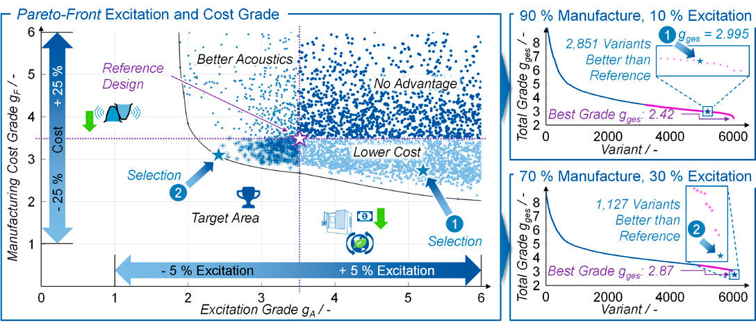

Figure 11 on the left shows the Pareto front determined after n = 20,000 iterations for the opposing grading of production costs (gF) and gear excitation behavior (gA). A population size of npop = 100 particles per iteration was used, whereby the oblivion rate a = 0.1 was parameterized. The mutation rate was set to m = 0.1. In sum, n = 6,042 tolerance designs were identified in a target range that was narrowed down to score values g < 10. Tolerance designs whose manufacturing grade gF < 3.5 (lower costs) are marked as triangles, while optimizations in the excitation are shown with squares. It was also possible to identify various variants that fulfill both aspects better compared to the experience-based reference tolerance design. These are marked with an asterisk. For the grading of the variants in the ranges gA/F = 1…6, the different percentage referring to the reference must be taken into account.
Figure 11—Pareto-Front generated with MOPSO and variant position of the target layouts.
An overall score gges can be determined from the designs close to the Pareto front by parameterizing the weighting factors fA and fF. Depending on the weighting selection, the focus can thus be placed on compliance with the acoustics or on reducing the production costs. In the diagrams in Figure 11 on the right, the best variants with a better (lower) overall score gges are listed in ascending order. Two variants were selected for comparison. One for an increased focus on acoustic, the other on cost reduction. The full identification of the Pareto-Front is an iterative and evolving process, so its characteristics can change as the number of iterations increases.
Comparison of the Different Tolerance Designs
The variants determined by MOPSO on the Pareto-Front were weighted for two exemplary cases. As an example, Figure 12 compares two design points that emerged as the best solution for the different weightings. For the optimization point with fF = 90 percent and fA = 10 percent, a tolerance design was identified that is pF = 7.5 percent cheaper to manufacture on the basis of the C-T cost model used compared to the reference. Based on the tolerance position of the geometric features in Figure 12, left, it can be seen that the tolerances of the gear have been increased compared to the reference tolerance design. To achieve the qualities of the gear, the algorithm suggests using finish hobbing instead of a honing process (estimation of quality loss due to heat treatment pinion shaft: -2.07 quality classes, gear: -1.55 quality classes), as this is the most cost-effective for the reduced tolerance requirements of the gear.
The tolerances for the pinion are also extended in order to reduce costs. One exception is the tolerance for the profile angle deviation, where a restriction is made to A 3.6, which corresponds to a virtual interpolated intermediate class. In particular, the stricter tolerancing of the geometric features on the housing is evident, which is carried out in return for the tolerance extension on the gears. In particular, the bearing seats of the pinion shaft require a reduction from the former quality class A 7 to A 4.4 in some cases. This is a plausible behavior, as the smaller bearing distance to gear on the shorter pinion shaft means that the effects of fitting deviations and bearing clearances have a much greater influence on axial position deviations than on the wheel shaft, which is longer. In the acoustic assessment, however, the design falls behind by around pA = +3.2 percent, which is still within the acceptable rating of gA = 5.2 < gA,max = 6. The plausibility of each favored design must be checked in detail to ensure its validity.
A tolerance design aimed at stricter compliance with the acoustic limit values can be seen in Figure 12 on the right. Here, an improvement in the acoustic behavior and the manufacturing cost score is achieved by limiting the tolerance of most of the features on the housing while at the same time increasing the gear and roller bearing tolerances, but while retaining the reference process chain. The comparison with the reference quality classes on the pinion shows, with the exception of the quality requirement for the flank form deviation ffβ, a possibility for extending the tolerances, which results in potential cost savings for the overall gearbox.

The percentage cost changes shown in Figure 12 relate to the reference costs determined by the stored cost model. It can be seen that for both compared designs, the main savings are made in the gearing of the pinion shaft and wheel. Due to the higher absolute cost shares of the gear geometry compared to, for example, dowel pin bores or bearing seats, cost savings can be achieved in total. The percentage savings for the pinion gearing can correspond to more than p > | 50 percent|, whereas the geometry-determining production steps for inserting precisely fitting bearing seats in the housing can sometimes be more expensive by p > |+150 percent|. This reciprocal exchange of tolerance specifications enables the excitation quality to be maintained, although the overall costs can be reduced. However, it can be stated that especially housing tolerances such as of the bearing seats or the positioning pins are relatively cheap features which should be manufactured in good quality. This is especially relevant if the distance of gear to the bearing seat is smaller.
