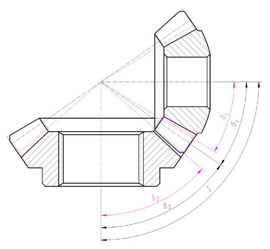

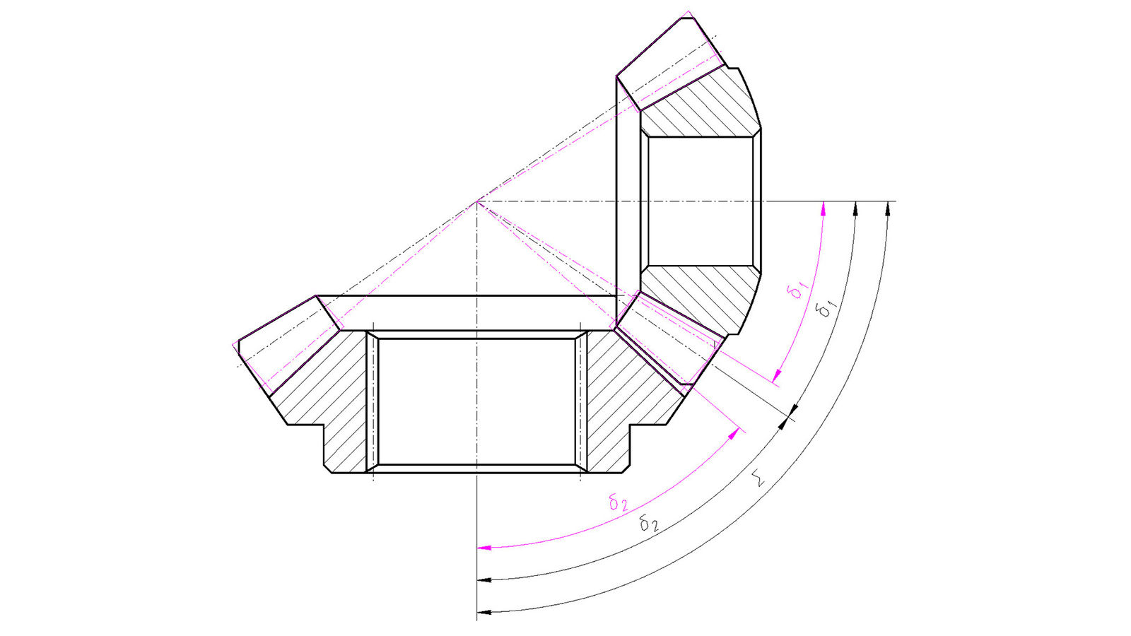

Figure 1 shows an example of a bevel gearset with the number of teeth z1 = 9 and z2 = 13, a shaft angle R = 90 degrees, a tooth height coefficient h = 0.8, a pressure angle a = 22.5 degrees, and profile shift coefficients x1 = 0.2 and x2 = −0.2. The pitch cones, drawn in black, have angles d1 = 34.695 degrees and d2 = 55.305 degrees (Ref. 2) and roll on each other without sliding.
If profile shift coefficients of x1 = 0.7 and x2 = 0.7 are introduced, the shaft angle Σ must be increased to achieve proper meshing. However, since this angle is fixed, it must first be preliminarily reduced so that after increasing it by applying two positive profile shifts, it ultimately reaches the specified value of 90 degrees. As a result, the pitch cone angles decrease and will no longer be in contact. Using the proprietary bevel gear calculation software at Oktoida, the pitch cone angles for these gearings with double positive profile shifts were calculated to be d1 = 31.534 degrees and d2 = 49.267 degrees, and are illustrated in pink in Figure 1. Additionally, tooth thickness must be adjusted to enable proper meshing, since those defined on the decreased pitch cones no longer apply due to the lack of rolling contact between these cones.
Figure 1—Bevel gearset—axial section.

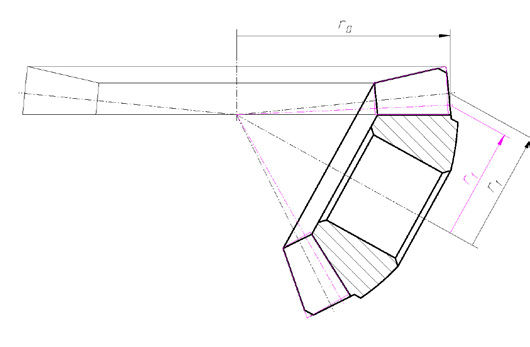

Figure 2 illustrates the original pinion, with a profile shift coefficient of x1 = 0.2, meshing with its planar generating gear (depicted in black). It also shows the pinion with a reduced pitch cone angle and a profile shift coefficient of x1 = 0.7, along with its planar generating gear (depicted in pink). Note that in the latter case, the rolling radius r1 has decreased while the generating gear radius r0 remains unchanged, resulting in a change in the generating ratio i = r1/r0. This effect is even clearer in Figure 5, where, in the shown kinematic setup of the generating process, only the value of this generating ratio has changed. Consequently, due to the change in the pitch cone angle, the generating motion is modified, causing changes in the generated profile angle (Ref. 1).
Figure 2—Pinion with a planar generating gear—axial section.

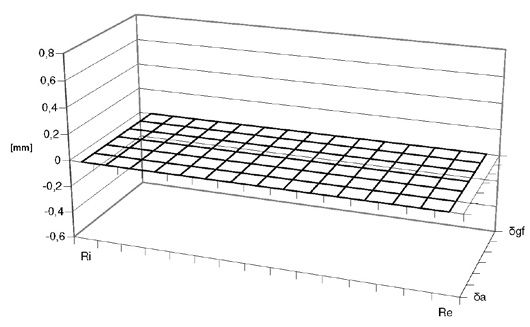

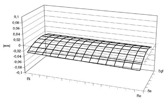

Using the same software, the octoid geometry of the original gear tooth flank was calculated in the form of a point cloud with corresponding normal vectors. This cloud extends from the heel (Re) to the toe (Ri) and from the outer cone (da) to the start of the generated profile at the root (dgf) and will serve as the baseline (zero geometry) for comparisons with geometries obtained through subsequent modifications. Next, in the same manner, the tooth flank geometry of the gear with a reduced pitch cone angle was determined. A comparison of these geometries is presented in Figure 3.
Figure 3—Tooth flank geometry—original vs. reduced pitch cone angle.

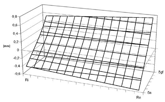

Subsequently, the function fitting the tooth flank geometry from the same software was used, yielding a pressure angle value of a = 31.910 degrees. The original geometry with zero sum of profile shifts and a modified pressure angle corresponds to the geometry with a double positive profile shift, as shown in Figure 4. It should be noted that, in the original case, both during gear generation and its operation in the transmission, the rolling cone is identical to the pitch cone; therefore, in both instances, the term “pressure angle” can be applied.
Figure 4—Tooth flank geometry—original with enlarged pressure angle vs. reduced pitch cone angle.

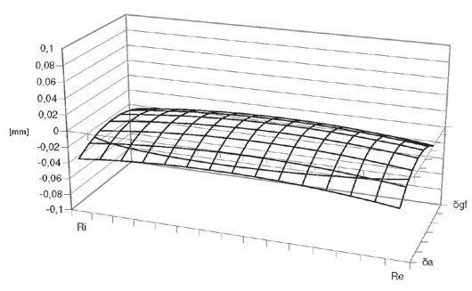

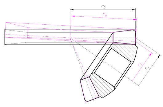

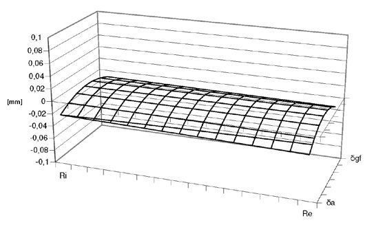

Figure 2 shows a planar generating gear; however, in industrial practice, conical gears are often used, such as the one shown in Figure 5. Figure 6 illustrates the effect of using such a conical gear—a crowning on the tooth profile is created.
Figure 5—Pinion with a conical generating gear—axial section.
Figure 6—Tooth flank geometry—original vs. conical generating gear.
The use of a conical generating gear causes a slight deviation of the pressure angle, since it is measured relative to the pitch cone of the generating gear rather than its plane of rotation. Therefore, Figure 7 shows the tooth geometry with the appropriate roll ratio correction and adjusted tooth thickness applied.
