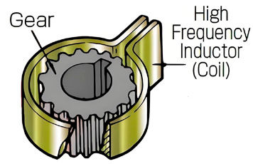

Induction (Surface) Hardening
Best at: Localized hard surface with a tougher core; efficient flow for many parts; can support distortion control when implemented well.
Where it fits: Moderate to high duty parts where selective hardening is practical and cycle time matters.
Limitations: Pattern coverage and uniformity; tooth-to-tooth variation; setup drift (coil path, scan strategy, quench stability).
Verification emphasis: Hardness mapping and depth checks at the highest-stress regions; distortion checks before/after finishing.
Figure 2—Induction hardens teeth fast with a coil.

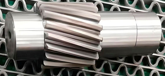

Nitriding
Best at: Hard surface with minimal distortion due to lower temperature; attractive for distortion-sensitive components.
Where it fits: Precision gears or parts where dimensional stability is the dominant constraint; wear/scuffing risk control in certain duty profiles.
Limitations: Typically thinner hardened layer; layer and compound-zone control; core must already be sufficiently strong.
Verification emphasis: Layer depth, near-surface hardness (often HV-based), microstructure/layer characterization, geometry checks pre/post.
Figure 3—Nitriding gives the shaft a hard, stable layer.

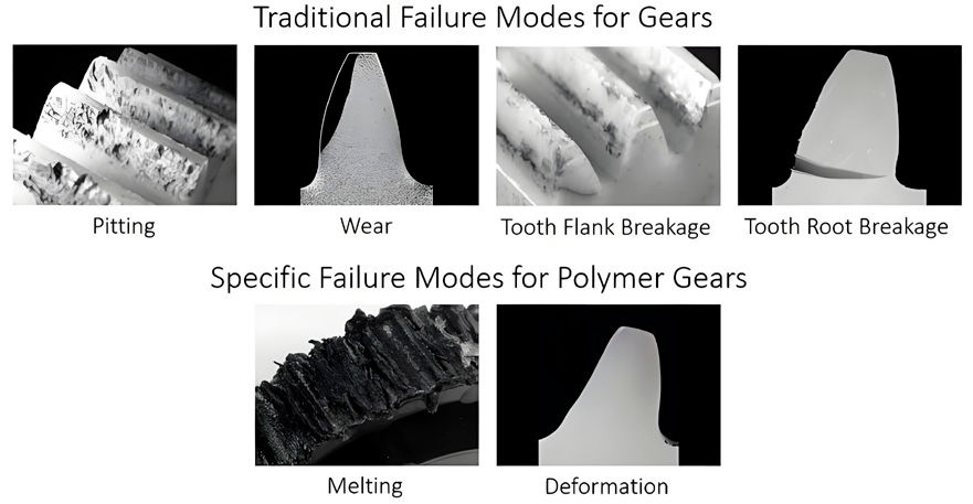

Figure 4—Typical gear damage patterns and failure appearances at a glance.

Failure Modes and Evidence Chains (Fast Troubleshooting)
When a program experiences early failures or fit problems, the fastest path is symptom → evidence → correction.
Pitting / Spalling
  • Symptom: pits growing into spalls on active flanks.
  • Evidence: duty severity review; case depth/gradient vs stress region; surface condition and cleanliness.
  • Corrections: revise duty assumptions; adjust case strategy or route; improve finishing/lubrication/cleanliness controls.
Scuffing (Adhesive Wear)
  • Symptom: smeared or torn surfaces, rapid damage progression under boundary lubrication.
  • Evidence: duty temperature and lubrication regime; surface condition; contact pattern and alignment checks.
  • Corrections: raise scuffing margin via lubrication/cleanliness/finish strategy; reconsider route if scuffing is dominant.
Tooth Fracture
  • Symptom: fracture often originating at root under shock.
  • Evidence: shock classification; core microstructure/hardness; stress raisers and origin analysis.
  • Corrections: ensure core robustness matches duty; stabilize process; adjust design margins or route as needed.
Fit or Assembly Problems After Heat Treat
  • Symptom: parts do not assemble or require excessive correction.
  • Evidence: geometry measurements pre/post; distortion scatter across loads; stock allowance vs correction capability.
  • Corrections: distortion control plan, fixturing/quench strategy, gating inspections, and finishing alignment.
