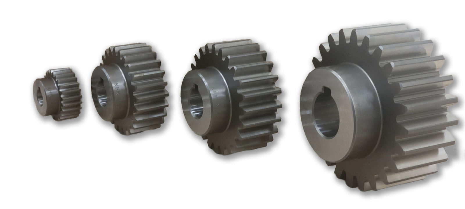

These 24-tooth gears in Modules 1.5, 2.5, 3, and 4 demonstrate how pitch selection—not tooth count—drives gear size, with coarser pitches enabling higher torque capacity at the cost of a larger footprint.

The final consideration for the size of a gear is the pitch. The pitch of a gear drives the formulas for size. A coarse pitch gear, such as a Module 4 spur gear with twenty-five teeth, will have a pitch diameter of 100mm and typically a face width of 40 mm. However, a medium pitch gear, such as a Module 1.5 spur gear with twenty-five teeth, will have a pitch diameter of 37.5 mm and typically a face width of 15 mm. If we normalize these two gears with both having a face width of 15 mm and both made from carbon steel with a design life of 40 weeks operating 40 hours per week, the Module 1.5 gear would have a maximum allowable bending strength torque of 26.7 Nm, but the Module 4 gear would have a maximum allowable bending strength of 189.8 Nm. These values show that the tooth size affects the load capacity when all other parameters are equal. However, the larger module gear has a significantly larger pitch diameter, which may not be suitable for the application.
Each of these parameters has an impact on the proper size for a gear that is best for the application. Young engineers need to understand that the size of a gear is an outcome of the needs of the application and not predetermined by the desire for the gear to be a particular size.
