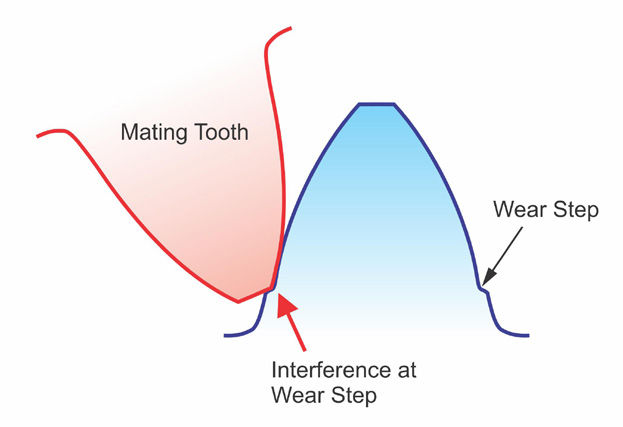

Adjusting the backlash at the time of replacing one member reduces the risk of root interference due to the wear step (see Figure 2) and small flank form changes on the member that is not replaced.
If there is a severe wear step between flanks and root fillet transitions on the member, which is not replaced, then the likelihood of an interference problem still exists. A severe wear step, as shown in Figure 2, can be detected visually or with a drawing pin.
Figure 2—Wear step in the root of a used gear member.

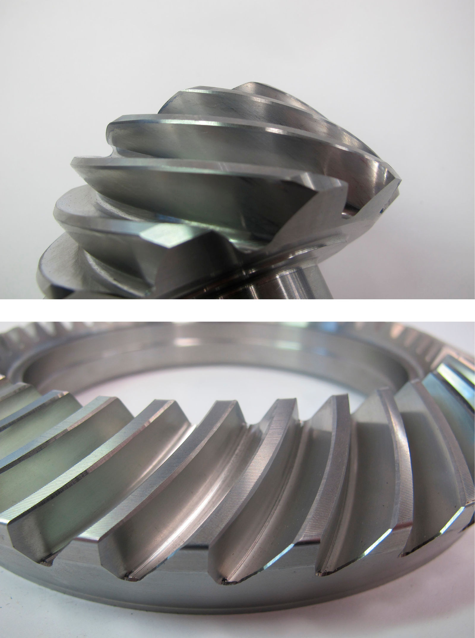

To account for a severe wear step in the root of the undamaged member, the replacement gear must be topland chamfered to prevent interference between the topland corner of the replacement part and the wear step between the flank and root on the teeth of the new member. Topland chamfering is not a widely used standard practice for the case of single-member replacements. The consequence of not applying the service backlash and the topland chamfering is, in many cases, a repeated failure of the unit in question and a costly repeated repair. Topland chamfers, as shown on a pinion (top) and a gear (bottom) in Figure 3, should only have a width of 10 percent of the whole depth of the teeth and an angle that is about 30 degrees to the flank profile at the tip of the teeth. Curved tip roundings are even better than straight chamfers and are recommended if the provision of machining these is available. Rounded top-land corners have advantages over straight chamfers in the case of replacing damaged and worn gears.
Figure 3—Topland chamfer on a pinion (top), and on a gear (bottom).

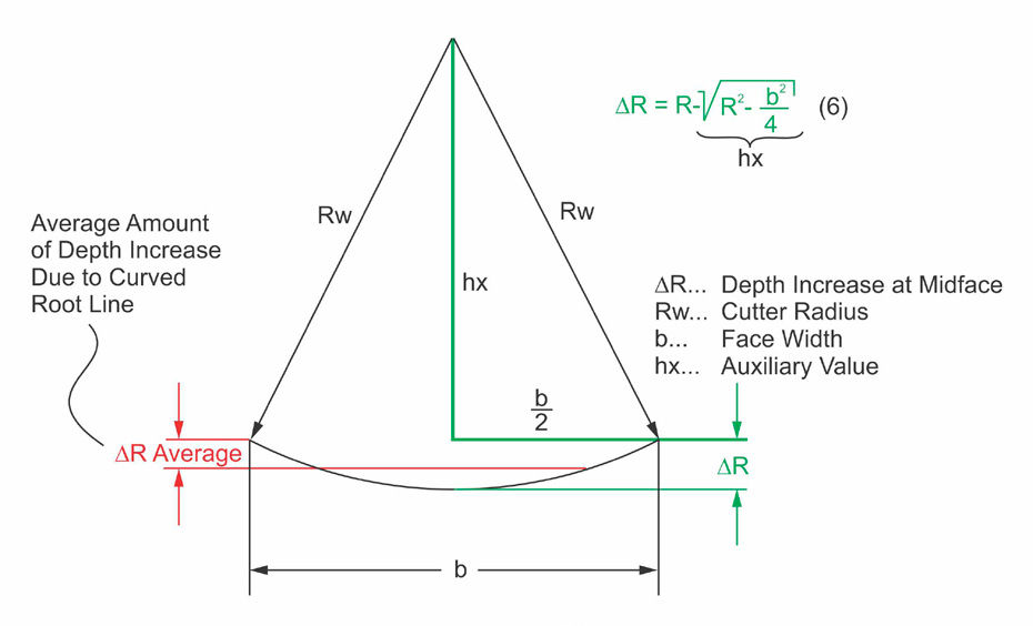

The curvature of the root line depends on the cutter radius, which results in a deeper tooth at the center of the face width. The calculation of the additional amount of root depth ΔR is explained in Figure 4.
Figure 4—Relationship between cutter radius, face width, and ΔR.

For a comparable Coniflex bevel gear with a root which is DR = 1 mm deeper at the center and 0 mm deeper at the ends, the following assumptions can be made:
Average value of deeper root over entire face = 60 percent of value at center (1 mm• 0.6=0.6 mm). Pressure angle at the stress critical 30-degree tangent is 30 degrees. The resulting root bending stress is equal:
(7)
The comparison example in Equations 6 and 7 shows that the effect of taller tooth at midface and larger root tooth thickness at midface cancel each other out, such that the Coniflex straight bevel gear shows even some reduction of calculated root stress compared to the straight bevel gear with a straight root.
The limits of this principle are given by the fact that in the case of a too large curvature of the root line, the hourglass-shaped root width will cause the cutter to mutilate the opposite flank. The output of the Gleason Straight Bevel Gear software gives a warning in cases where this is critical. The rule is that the relation between face width and cutter radius should be below 40 percent to achieve optimal root geometry.
(8)
40 percent of the radius of a cutter with 9 in. diameter is (4.5 in. or 114.3 mm) • 0.4 = 45.7 mm, which leads, in the case of a recommended face width of 33 percent of the outer cone distance, to a maximal ring gear diameter of about 275 mm. This dimension is close to the limit of Phoenix 275 or Phoenix 280 machines, where the maximal Coniflex cutter diameter is equal to 9 in., “which closes the circle” (Ref. 2).
