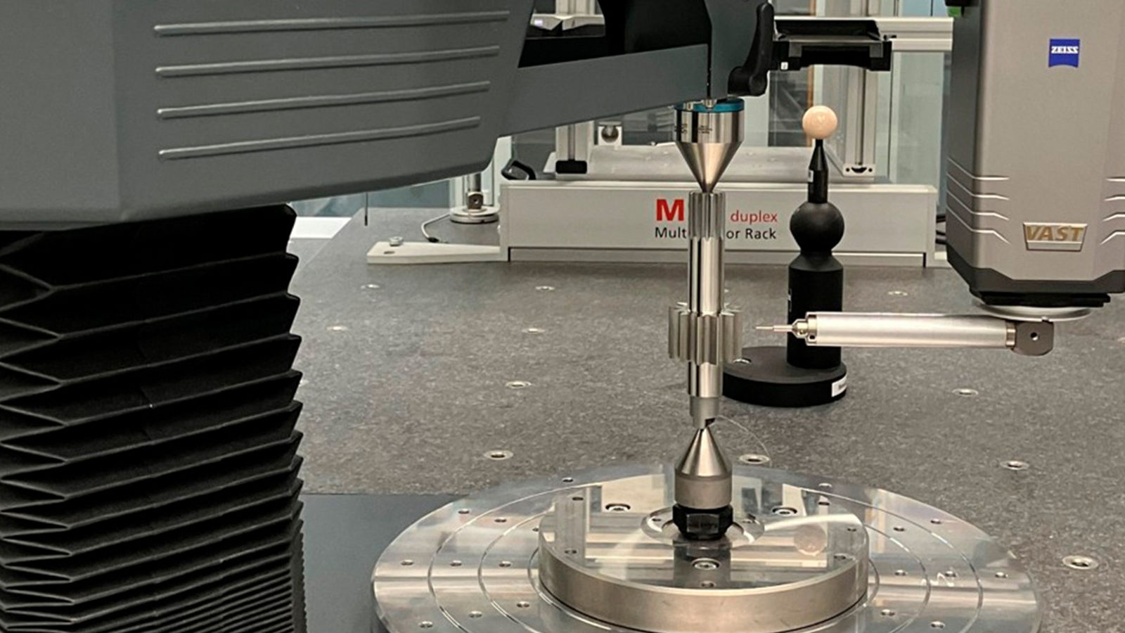

For the comparison measurements, a spur gear was used. Due to the profile shift and the protuberance, this gear already represents a medium to difficult accessibility for optical measuring systems and was evaluated as a suitable study object. The geometry data of the gear can be found in Table 1.
To ensure comparability with the results, a detailed task description was created. This includes all relevant aspects such as the definition of the reference elements and the reference system, the number of measuring points, the filter settings, as well as the relevant characteristics and tolerances. Two tactile measuring systems from different manufacturers and an optical measuring system were used for comparison measurements. The tactile measuring systems used were a Klingelnberg P40 gear measuring instrument (GMI) (Ref. 1), available at Bosch (test setup see Figure 1), and a Zeiss Prismo Verity coordinate measuring machine (CMM) with tailstock (Ref. 1) (test setup see Figure 2). As a representative non-contact optical measuring system, a Zeiss Atos Q fringe projector was used in a Zeiss ScanBox 4105 (test setup see Figure 3).

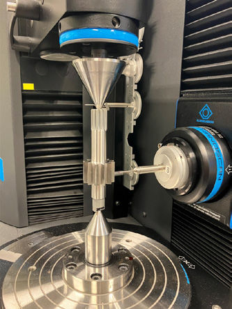

Figure 1—Klingelnberg P40.

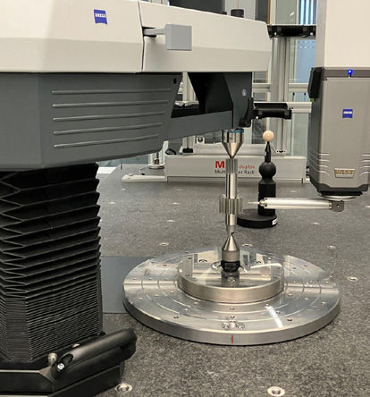

Figure 2—Zeiss Prismo verity.

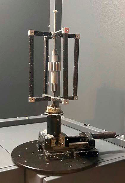

Figure 3—Zeiss Atos Q.
The procedure for the comparison measurements was divided into two steps. In step 1, a tactile system comparison of the existing Klingelnberg GMI with a Zeiss CMM was carried out. This comparison served firstly to validate the tactile measurement results obtained by the Klingelnberg GMI with the tactile measurement results obtained from the Zeiss CMM and, secondly, forms the basis of the measurement and evaluation strategy for the non-contact optical measurement system from Zeiss. In the following chapters, the measurement results are divided into two main blocks: Classic characteristics and waviness characteristics. Classic characteristics refer to all determined characteristics according to ISO 1328-1:2013-09; for better presentation, the individual characteristics have been summarized in the main categories profile, helix, pitch, and runout. In addition, depending on the workpiece, tooth thickness values such as spanwidth and measurement over two balls were compared with each other. Waviness characteristics are understood to be the orders with the corresponding amplitude (O/a), determined from the order spectrum using the compensating sine method (Ref. 2) and the helix angle of waviness (βw) (Ref. 3). The measurement results presented in the following chapters result from several repeatability measurements per measuring system. At least ten repeatability measurements were carried out and compared with each other according to the mean value per characteristic and system.
Bosch-Shaft Tactile System Validation
The measurement scope on the Bosch-Shaft with twelve teeth included an all-tooth measurement of all profiles and helices, including the pitch and runout measurement (or extraction of the pitch points from the profile data), as well as the measurement of tip and root circles on all teeth. In addition, one tooth was measured topographically with twenty-one profile sections.

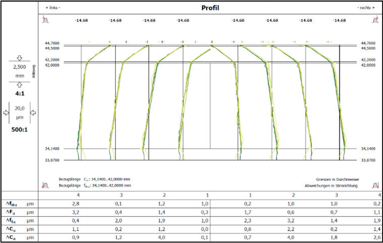

In the first step, the tactile measurement results of the Klingelnberg P40 were compared with those of the Zeiss Prismo verity. For a better visual and numerical comparison of the measurement data, the function actual-actual comparison (Ref. 4) of the Zeiss Gear Pro involute gear metrology software was used. Figure 4a shows the actual-actual comparison data as an example for the classic characteristic profile for the measurement data of Klingelnberg P40 (green) and Zeiss Prismo verity (blue). The color coding is retained throughout the report. Even when the results are greatly enlarged and exaggerated, the very good comparability of the measurement data of both tactile measuring systems can be seen in Figure 4b.
Figure 4—Actual-actual comparison profile Bosch-Shaft Tactile: a) overview and b) enlarged.

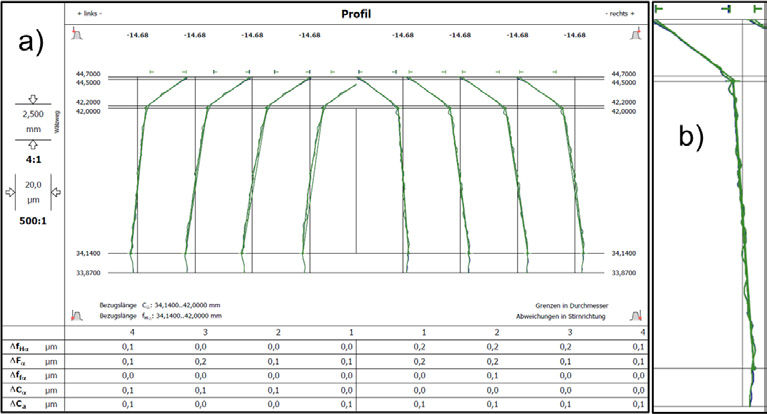

In the table of Figure 4a, the numerical differences (Δ) of the individual characteristics are shown. For all determined characteristics of profile and helix the differences are Δ < 0.5 μm. In the determined characteristics of pitch, runout, and spanwidth, the respective differences are Δ < 1.5 μm.

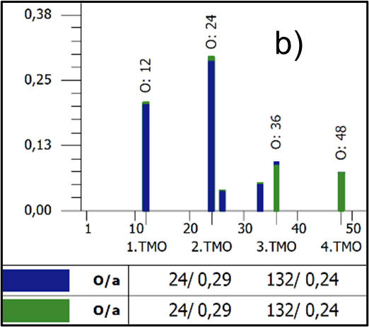

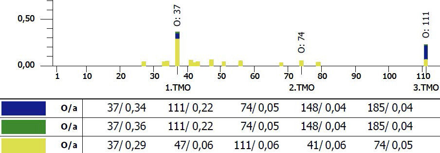

Figure 5a shows the actual-actual comparison for the waviness characteristic order spectrum as an example of the profile measurement data. Figure 5b shows the very good comparability of the tactile measuring systems, which is enlarged and highlighted in color. The differences Δ are also visible in numerical form on the measurement report and were in the range Δ < 20 nm.
Figure 5—Actual-actual comparison order spectrum profile Bosch-Shaft Tactile: a) overview and b) enlarged.

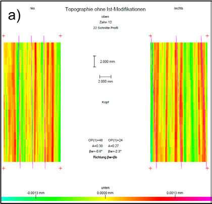

The actual-actual comparison is not suitable for comparing the waviness characteristic helix angle of waviness (βw). For this purpose, the respective measurement reports of the color-coded topography by Zeiss and Klingelnberg were visually compared with each other. The differences Δ of the determined helix angles of waviness were in the range Δ < 0.5° (Figure 6).
Figure 6—Color-coded topography Bosch-Shaft Tactile: a) Klingelnberg P40 and b) Zeiss Prismo verity.

The physical measuring principle of fringe projection is fundamentally different from the tactile measuring principle. The physical limitations and special topics of optical measurement methods were discussed in detail in VDI Report No. 2393, 2021 (Ref. 5). The very good comparability of the tactile measurement results from section 2 was classified as sufficiently accurate for the system validation. The measurement and evaluation strategy of Zeiss Prismo verity was thus defined as the basis for the evaluations with Zeiss Atos Q. The special feature of the Gear Pro involute gear metrology software from Zeiss is that the same measurement program can be used for the evaluation of non-contact measurement data in STL format as for tactile measurement. This offers the advantage that, despite the different physical measurement principles, no further uncertainty contribution regarding the measurement strategy must be considered. In principle, however, as shown in Ref. 5, various restrictions must be observed for a high-quality measurement. The following relevant points are to be mentioned as examples: spraying-in of the surface to minimize reflections; ensuring accessibility in areas that are difficult for optical systems, such as the tooth root or the transition area to the protuberance; and sufficiently high point density to minimize the influence of polygonization (merge individual scans into a final mesh), see Figure 7.

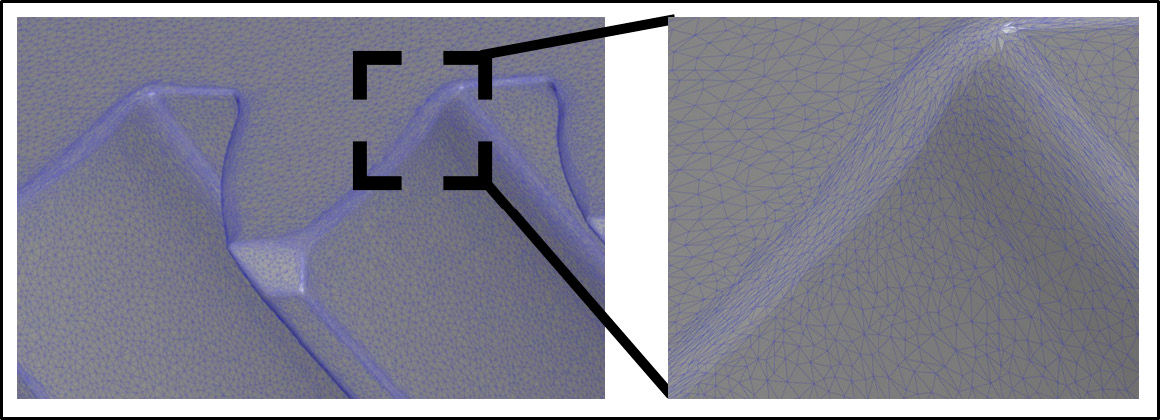

Figure 7—Measurement point density and STL data model after polygonization.
The measurement scope for evaluating the Bosch-Shaft with twelve teeth has remained identical to that used for the tactile validation measurements when evaluating the optically determined data with the Zeiss Atos Q. However, there is a significant difference in the recording of measuring points. For the subsequent mathematical evaluation regarding gear characteristics, the complete recording of the workpiece is necessary. Depending on the number of teeth, generating the data set takes significantly longer than tactile measurement with a GMI or CMM. An overview of the measurement scope and the measurement times is shown in Table 2.

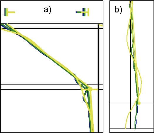

The system-related lower measuring point density of the fringe projection generates, especially in profile direction, rounding in edge areas due to polygonization and thus leads to falsification of the measurement result. At the Bosch-Shaft, there are only about 100 points in the profile direction after polygonization. Figure 9 visualizes the profile comparison results from Figure 8, enlarged for fringe projection systems’ “critical” edge areas after polygonization and gear evaluation, transition area involute zone into profile tip relief, and transition area into root zone/protuberance.
Figure 9—Bosch-Shaft tactile/optical actual-actual comparison profile enlarged: a) tip and b) root area.
For all determined characteristics of profile and helix, the respective differences are Δ < 6 μm. For the determined characteristics of pitch, runout, and spanwidth, the respective differences are Δ < 3 μm. The differences determined are thus within the known orders of magnitude of tactile/optical comparison measurements of gears (Ref. 5).

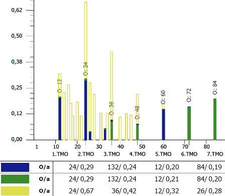

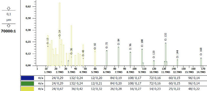

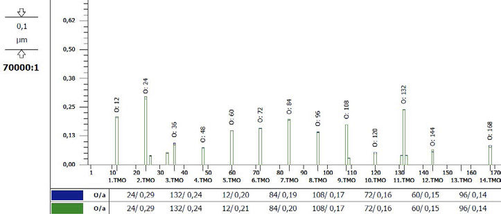

The differences for the waviness characteristic order spectrum are shown as an example for the profile measurement data in Figure 10. In Figure 10b, you can see the noise of the order spectrum of the measurement data determined by fringe projection (yellow) in the low-frequency range and the lack of detection of orders in the high-frequency range in an enlarged and colored variant. This makes it difficult to reliably detect frequencies. The numerical differences in the orders found are in the range Δ > 50 nm.
Figure 10—Bosch-Shaft tactile/optical actual-actual comparison order spectrum profile: a) overview and b) enlarged.

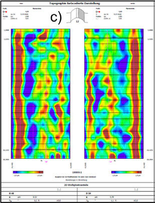

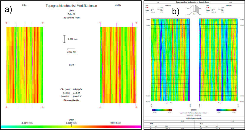

The comparability of the waviness characteristic helix angle of waviness (βw) for the largest order found is shown in Figure 11. The differences between the two tactile measurement results and the optical measurement result are in the range of Δ < 1.5°. In Figure 11, there is a visual comparison of the optical system given, but it is presented in a “damped” way. The reason for the visual differences can be explained by the noisy result of the order spectrum; the physical system-related restrictions cannot be dismissed out of hand at this point. The differences determined by the tactile system validation and the tactile/optical comparison are summarized in Table 3.
Figure 11—Color-coded topography Bosch-Shaft tactile/optical: a) Klingelnberg P40, b) Zeiss Prismo verity and c) Zeiss Atos Q.

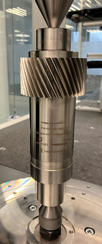

FVA Involute Waviness Artifacts Tactile/Optical Comparison
Since there were no conspicuous waviness on the Bosch-Shaft, but the question of reliable detection of waviness characteristics, with fringe projection systems for Bosch was in the foreground, two waviness artifacts from the Forschungsvereinigung Antriebstechnik e.V. (FVA) from the project FVA involute waviness artifacts (Ref. 6) could be used for the comparison. The two waviness artifacts are grinded artifacts with specifically applied waviness of different orders (Figure 12). Both waviness artifacts are helical external gears with: number of teeth (z) 37, normal module (mn) 1.75 mm, and facewidth (b) 40 mm. For the tactile/optical comparison, the waviness artifact B1 (order 37, 1. Tooth Mesh Order [TMO]) and D1 (order 45, 1. TMO ± 8) were available. In the FVA research project no. 733 I, twelve tactile Klingelnberg GMI were used to determine the waviness applied by production technology in a ring comparison in 2018. The amplitudes of the waviness were in a range < 0.5 μm.
Figure 12—FVA involute waviness artifact B1.
For the results presented below on the two FVA involute waviness artifacts, the same methods, repeatability measurements, and results presentations were used as described in the sections “Bosch-Shaft Tactile System Validation” and “Bosch-Shaft Tactile/Optical Comparison” for the Bosch-Shaft Table 4 shows the measurement scope and the measurement times. The differences of all determined characteristics are shown in Table 5.

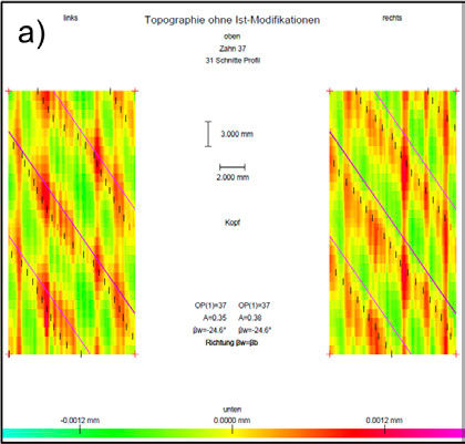

As an example, Figure 13 shows the waviness characteristic order spectrum profile of the FVA involute waviness artifact B1 for the measurement data of Klingelnberg P40 (green), Zeiss Prismo verity (blue), and Zeiss Atos Q (yellow).
Figure 13—Tactile/optical actual-actual comparison order spectrum profile FVA involute waviness artifact B1: a) overview and b) enlarged.

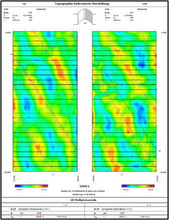

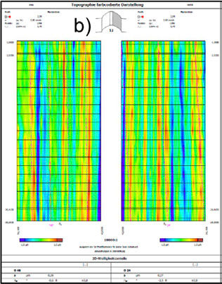

In Figure 14, the color-coded topography plots for the visualization of the waviness characteristic helix angle of waviness (βw) of the FVA involute waviness artifact B1 are shown, in Figure 15, correspondingly, for the FVA involute waviness artifact D1.
Figure 14—Tactile/optical color-coded topography FVA involute waviness artifact B1: a) Klingelnberg P40, b) Zeiss Prismo verity and c) Zeiss Atos Q

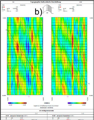

Figure 15—Tactile/optical color-coded topography FVA involute waviness artifact D1: a) Klingelnberg P40, b) Zeiss Prismo verity, and c) Zeiss Atos Q.
The results obtained on the FVA involute waviness artifacts tend to be comparable to those on the Bosch-Shaft, and even significantly better for some characteristics, since the surface quality of the artifacts is of higher quality than that of the Bosch-Shaft.
