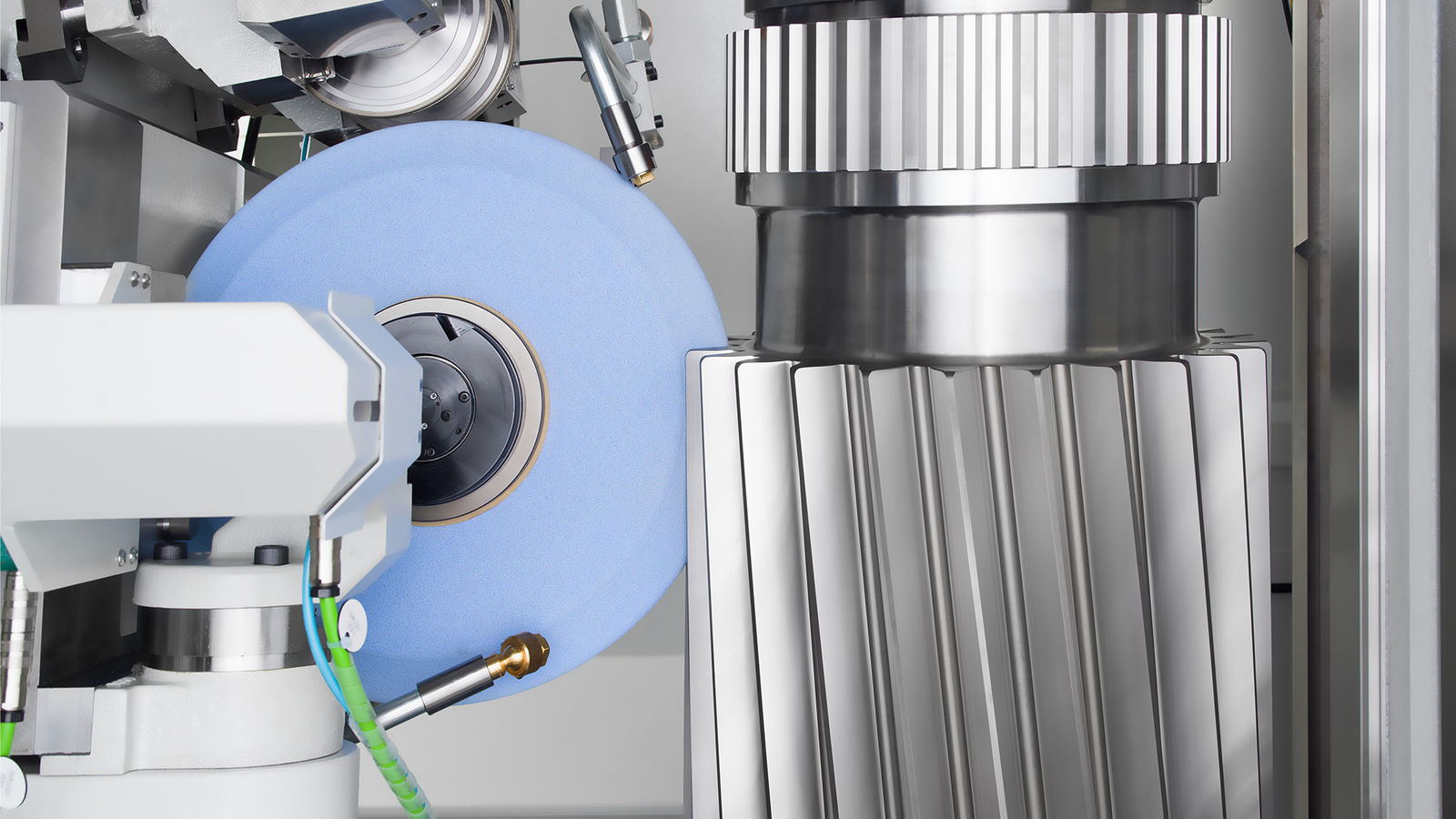

Profile grinding is the hard-finishing process of choice for large gears with demanding requirements regarding load transmission, running smoothness, and complex tooth modifications. No other hard-finishing process offers a comparable level of flexibility across such a wide range of applications. Profile grinding can be applied to very small as well as very large gears, to external and internal gearing, to involute and non-involute tooth forms, to components with and without interfering contours, and to both simple and highly complex tooth modifications. Furthermore, profile grinding allows the achievement of excellent quality levels that cannot be attained by any other hard-finishing process over this broad application range.
Traditionally, the only disadvantage attributed to profile grinding has been its productivity. As a single-tooth-gap process, it is associated with higher nonproductive idle times compared with continuously generating processes. Through consistent further development of both process technology and machine design, however, this perceived disadvantage has been largely eliminated. This article presents examples illustrating how material removal efficiency during profile grinding can be significantly increased by optimizing the infeed strategy.

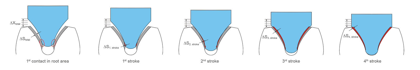

In conventional profile grinding, the total stock to be removed—including heat treatment distortion—is typically removed successively in multiple grinding strokes or passes. The grinding wheel is dressed to the final tooth gap geometry, including any specified profile modifications. Due to the remaining stock, however, the grinding wheel does not initially fit into the tooth gap. As illustrated in Figure 1 (left side), contact occurs only in the lower profile region near the tooth root.
Figure 1—Contact conditions using a conventional infeed strategy.

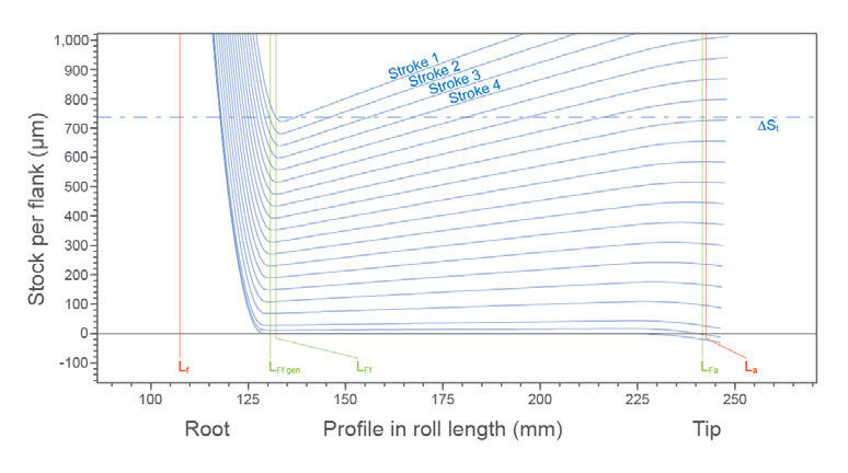

If the same radial infeed is applied in each grinding stroke, material removal during the first strokes is very limited and concentrated primarily in the lower portion of the tooth profile toward the root. Full contact along the entire tooth profile is achieved only in later strokes (in the example shown, starting with the third of four strokes). Consequently, the full material removal potential of the process is not utilized from the beginning but only during subsequent strokes. The initial strokes are therefore highly inefficient, even though the same infeed values and feed rates are applied as in all other strokes. This inefficiency can be clearly observed by analyzing the spindle power used during grinding (Figure 2, left side).

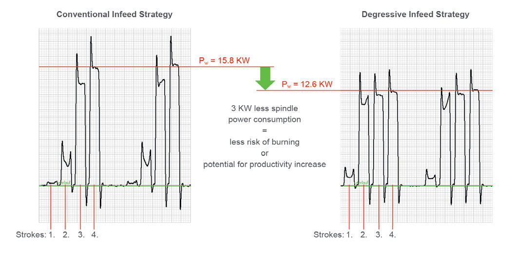

Figure 2—Spindle power consumption conventional infeed strategy versus degressive infeed strategy.
In the example shown, the first two of four grinding strokes require only very low spindle power, reflecting the extremely low material removal rate in these strokes. Only during the third and fourth strokes does spindle power reach the level corresponding to the defined process parameters. A noteworthy detail is that the highest spindle power of 15.8 kW occurs in the final stroke. In addition, this infeed strategy results in uneven loading of the grinding wheel along the tooth profile, which can lead to premature and unevenly distributed wheel wear.

Uneven material removal associated with the conventional infeed strategy can be partially compensated for by using a degressive infeed strategy. In this case, larger radial infeed is applied in the initial strokes, followed by smaller infeed in the later strokes. The effect of this strategy can again be clearly seen by evaluating spindle power demand (Figure 2, right side).
Although full contact along the entire tooth profile is still not achieved in the first stroke, the subsequent strokes show significantly higher and more evenly distributed spindle power levels. In addition, the maximum spindle power required (12.6 kW) is approximately 3 kW lower than with the conventional strategy, even though the same gear geometry is ground. This reduction in maximum spindle power corresponds either to a lower risk of grinding burn or to additional potential for increasing feed rates and thus productivity.

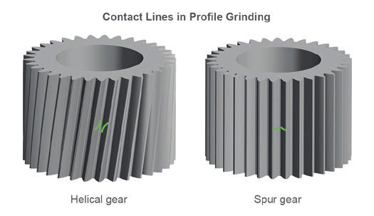

Different swivel angle settings are commonly used in practice, depending on the intended objective. While the contact line between the grinding wheel and a tooth gap of a spur gear (β = 0) lies in a single plane—the axial plane—this contact line is spatially distributed along the tooth flank in helical gears (β ≠ 0) (Figure 3).
Figure 3—Contact lines in profile grinding.
The contact line, therefore, extends axially along the tooth gap on both the left and right flanks. The start position, end position, and axial length of the contact lines on the two flanks can be strongly influenced by the selected swivel angle. Each swivel angle variant requires an individually calculated and dressed grinding wheel profile.
In conventional double-flank profile grinding, the swivel angle is often selected such that the contact lines on the left and right flanks are located at the same axial position. This ensures that the grinding wheel engages and disengages both flanks simultaneously during a grinding stroke, preventing undesired entry and exit effects caused by grinding-force-induced flank deflection. Such effects often appear in measurement as unwanted flank-line deviations at the beginning and end of the contact zone.
Other swivel-angle variants are used, for example, to minimize the axial extension of the contact line, thereby largely avoiding bias/twist effects during single-flank grinding. Additional swivel angle settings can be applied to achieve balanced peak positions of flank line crowning (cβ) on the left and right flanks.

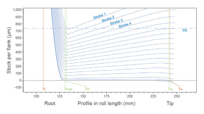

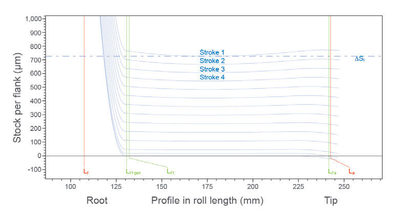

Figures 4 to 6 show the actual material removal per stroke for the different variants, with the tooth flank allowance in µm plotted on the vertical axis and the tooth profile plotted as roll length on the horizontal axis from the root (Lf) (left) to the tooth tip (La) (right). Analysis of the material removal per stroke shows that the conventional strategy requires seven strokes before full contact along the entire tooth profile is achieved. With the degressive strategy (Figure 5), full contact occurs after five strokes, while with the A(X) infeed strategy (Figure 6), full contact is achieved starting with the second stroke. The diagrams further illustrate how closely the grinding wheel profile conforms to the tooth gap geometry when using the A(X) infeed strategy, as indicated by nearly parallel material removal curves across successive strokes.

Figure 5—Material removal for all passes with a degressive infeed strategy.

Figure 6—Material removal for all passes with the A(X) infeed strategy.
In all three strategies, the maximum material removal measured perpendicular to the tooth flank is identical. This indicates that the significantly shorter cycle time achieved with the A(X) infeed strategy does not increase the risk of grinding burn.

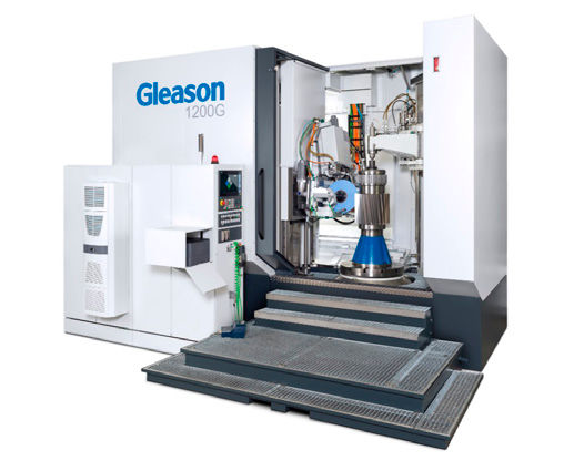

The A(X) infeed strategy is available with many other technological functions, such as smart dressing, wobble and eccentricity compensation, and twist-controlled double-flank grinding to maximize efficiency, productivity, and gear quality. These functions are implemented on all high-precision Gleason profile grinding machines, covering gear sizes up to 6,000 mm in workpiece diameter.
Figure 7—All Gleason profile grinding machines up to 6,000 mm in workpiece diameter feature the A(X) infeed-strategy software.
