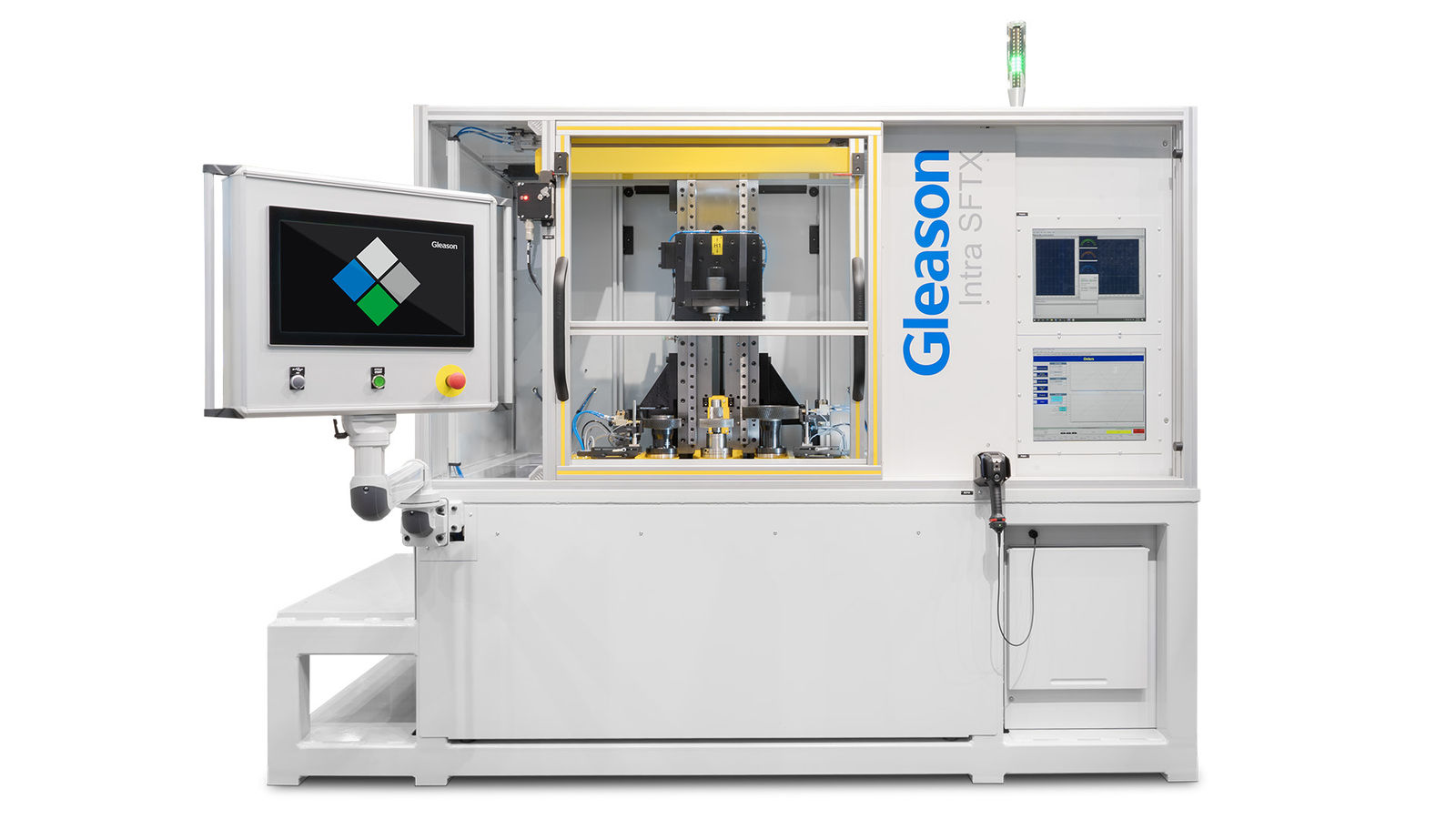

Gleason’s Intra SFTX Single-Flank Testing System with Twin Spindle for single or compound external gears. (All images: Gleason Corporation)

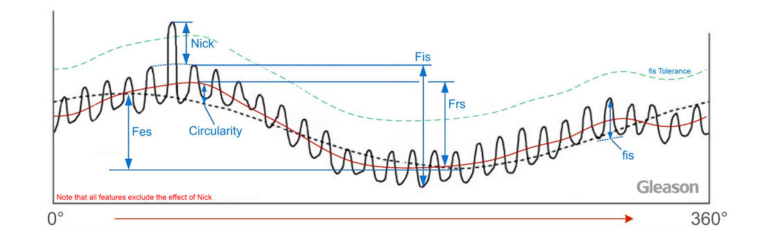

This TE technique is better suited to measure and detect lower-order errors such as: single-flank total composite action, single-flank tooth-tooth action, single-flank runout, single-flank circularity, and single-flank concentricity.

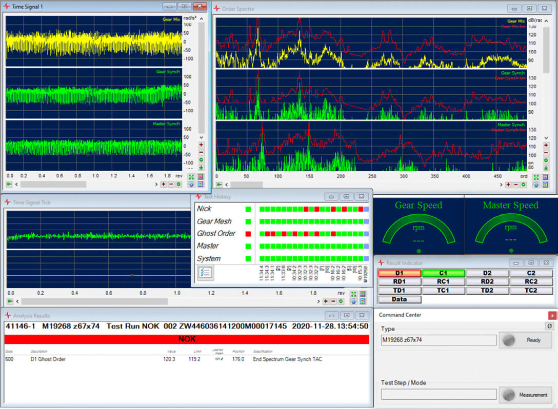

TA is to use a method of rotational synchronous time signals, with data collected from torsional accelerometers, to focus on NVH-related issues in the measured component. These errors can be time domain-based errors like nicks or gear modulation due to runout and circularity, and they can be order domain-based errors like gear mesh energies, side bands, and ghost orders. These order domain errors can occur on a sub-micron level.

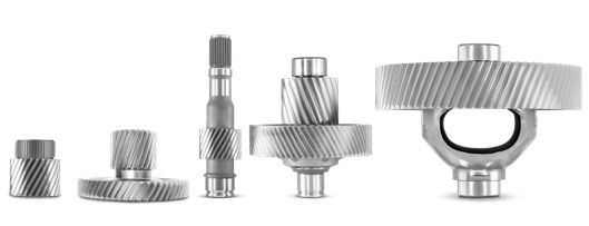

The Intra SFT Series by Gleason is designed to measure a wide range of drivetrain components.

Torsional acceleration (TA) testing.

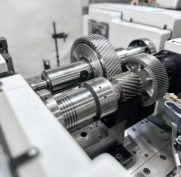

Gleason’s Intra SFTX with integrated axial alignment option delivers precise and repeatable measurement results for complex coaxial gearboxes with compound gears.

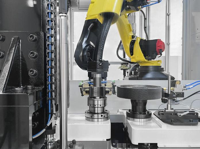

All Gleason Intra SFT Single Flank Testing Systems can be fully automated and seamlessly integrated into any manufacturing environment.
