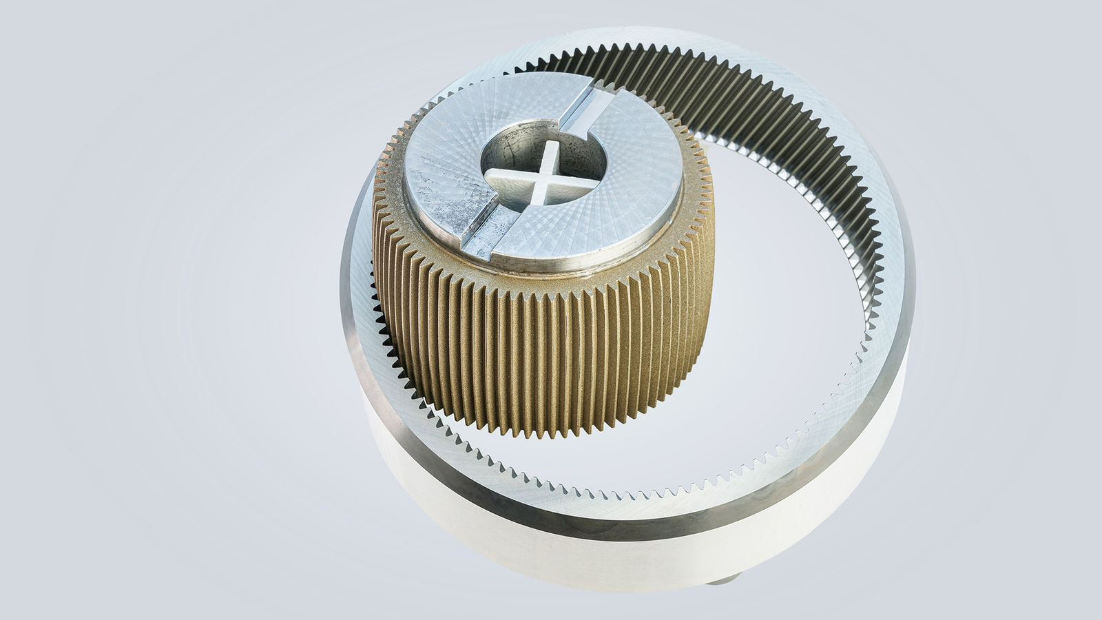

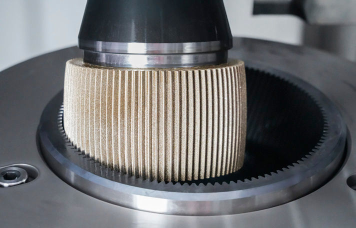

SkiveFinishing runs the kinematics of gear skiving but replaces the defined-edge cutter with an electroplated tool carrying cubic boron nitride (CBN). Material comes off by the microcutting action of abrasive grains, as in grinding.
SkiveFinishing is based on the same kinematics as gear skiving. Non-dressable, electro-plated skiving tool with multiple shift positions. (All images: Liebherr)
SkiveFinishing is based on the same kinematics as gear skiving. Non-dressable, electro-platedskiving tool with multiple shift positions. (All images: Liebherr)
Gear skiving is a continuous generating process: the pinion-type tool and the workpiece rotate in a fixed ratio about axes set at a shaft angle, and the resulting sliding velocity along the tooth does the cutting. The tool feeds axially along the line of contact, removing stock with a single galvanically bonded layer of CBN rather than a sharpened edge. That is the source of the fine surface finish, and the reason for a constraint discussed below.

The electroplated CBN tool is non-dressable, and that single fact shapes the process. A grinding wheel can be reprofiled in-house when it loses form; a single plated layer of grit cannot be touched up that way, so when it wears out, the tool goes back to Liebherr’s Ettlingen site to be stripped and re-plated.
The design compensates in two ways. The tool has a crowned form and several shift positions across its width; as one wears, it indexes axially to fresh CBN, much as a hob is shifted along its length. And because that form is fixed, the flank modifications normally dressed into a grinding wheel, such as tip relief, profile crowning, and lead, are built into the tool instead and imparted directly to the part, even on internal gears that would otherwise require profile grinding.

In initial trials on its LK-series skiving machines (designated by workpiece-diameter range, LK 180–280 and LK 300–500), Liebherr reports gear quality within ISO 1328-1 Class 5 and surface roughness of Ra < 0.4 µm, figures Mehr presents in his Emerging Technology webinar (see sidebar). Class 5 places the accuracy in the range more often associated with ground gears than cut ones.
