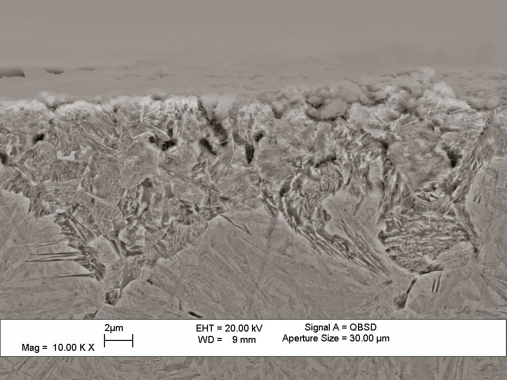

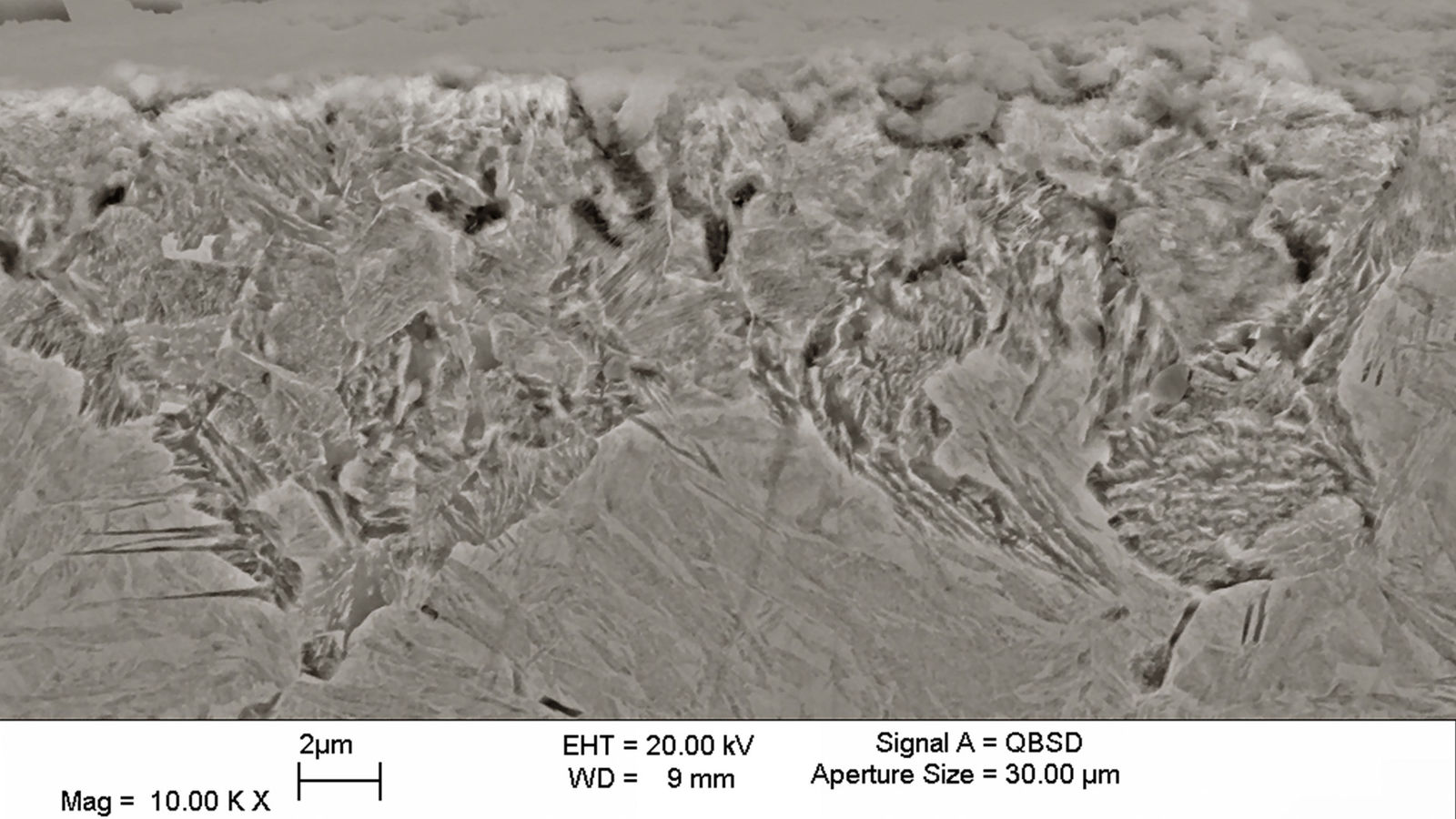

Why Gas Carburizing Is an Issue
During gas carburizing of steel, there is a low partial pressure of oxygen. Under these conditions, alloying elements with a strong thermodynamic affinity for oxygen, such as silicon, chromium, and manganese, tend to undergo selective oxidation that propagates along grain boundaries. This results in the inward growth of oxide phases from the surface into the steel substrate, often referred to as intergranular oxidation (IGO) (Ref. 1).
This leads to localized depletion of alloying elements in the vicinity of the oxides formed, with a resultant reduction in the hardenability in these regions. When the steel is quenched, this reduction in hardenability increases the likelihood of forming non-martensitic microstructures in the affected areas, see Figure 1.
Figure 1—Surface oxidation of 20MnCr5 after case carburizing. (All images: Ovako)
Furthermore, the reduced hardenability near the surface means that the transformation of the surface layer occurs earlier than in the underlying case during quenching. As the deeper regions of the case subsequently transform martensitically, accompanied by volumetric expansion, tensile residual stresses are introduced at the surface.
The net effect of the oxide and the low-strength surface structure, in combination with tensile residual stresses, is to adversely affect fatigue performance and increase susceptibility to crack initiation.

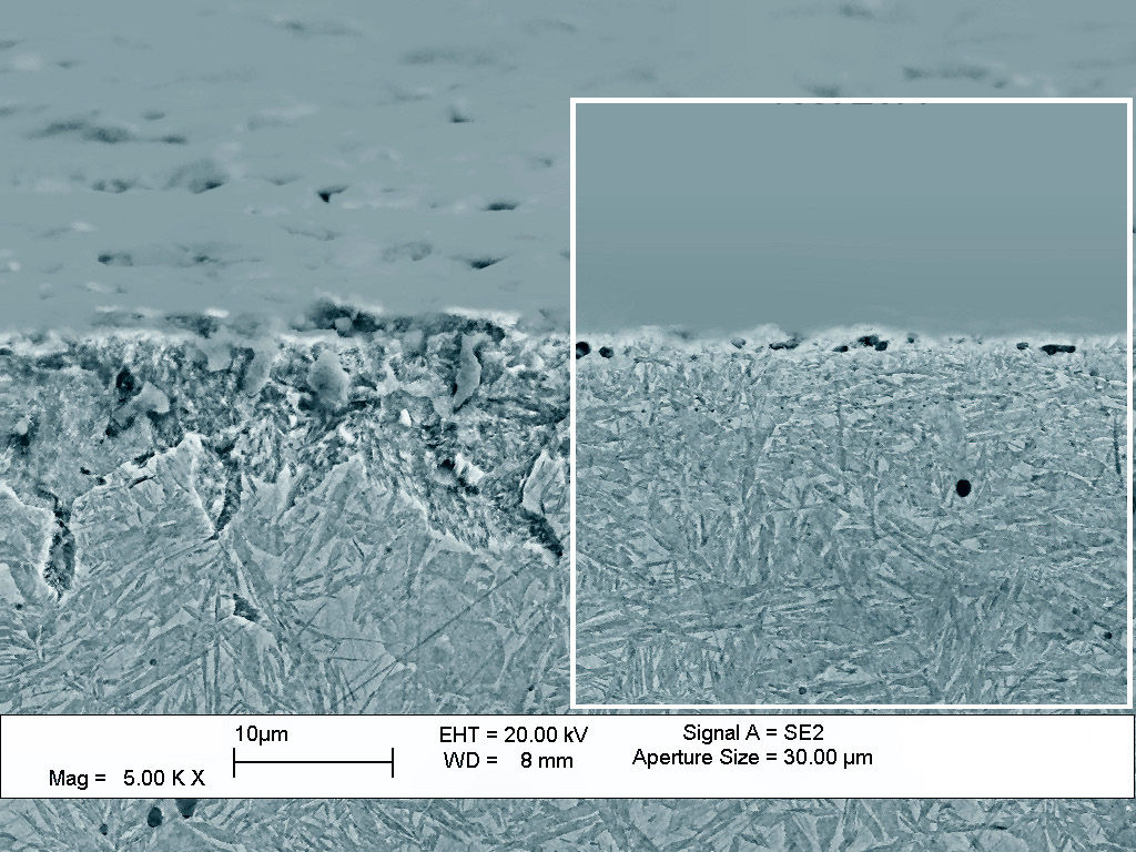

The development program was driven by the need to overcome the limitations of conventional carburizing steels like 20MnCr5, particularly their susceptibility to IGO and reliance on post-treatment processes such as grinding and shot peening to achieve their required mechanical properties.
The result is 20NiMo9-7 (158Q), alloyed with nickel (Ni) and molybdenum (Mo), elements with low oxygen affinity and strong hardenability contributions, while minimizing the presence of silicon (Si), manganese (Mn), and chromium (Cr)—see Table 1. This composition suppresses IGO and enables the formation of a fully martensitic surface layer with high compressive residual stresses, even under standard atmospheric carburizing conditions, see Figure 2. Additionally, this steel is produced via a premium production process (IQ-Steel), which ensures low levels of detrimental non-metallic inclusions. This ensures that steel cleanness is not the limiting factor for the fatigue properties.
Variant C%Si%Mn%P%S%Cr%Ni%Mo%V%
158Q/20NiMo9-7*Min0.18-0.22--0.352.250.67-
Max0.210.100.300.0250.0020.402.350.700.100
Table 1—Chemical composition of 158Q.
Figure 2—Surface appearance in 16MnCr5 and 158Q subjected to the same gas carburizing process.
The result is a steel that delivers high fatigue strength directly after carburizing, reducing or eliminating the need for post-processing. This makes 158Q particularly suitable for complex or small gear geometries where grinding or shot peening are impractical, offering a streamlined, cost-effective, and sustainable manufacturing route.

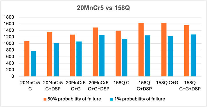

In the AGMA technical paper (Aylott et al., 2024), 158Q was tested under various surface conditions, carburized, shot peened, ground, and in different combinations of them (Ref. 6). It consistently outperformed 20MnCr5, even when the latter was subjected to duplex shot peening or grinding, see Table 5. While post-treatments further improved performance, the gains were relatively small, indicating that the as-carburized properties were already reaching a level normally expected after shot peening, see Figure 3.
Root surface conditionStandard deviationBending fatigue strengthImprovement 1%
 50% probability1% probability
MPaMPaMPa
20MnCr5Carburized79.41,0777710%
Carburized + duplex shot peened90.41,3601,01231%
Carburized + ground56.31,2741,06338%
Carburized, ground + duplex shot peened60.51,4911,26464%
15BQCarburized67.41,3941,14248%
Carburized + duplex shot peened98.51,6291,25062%
Carburized + ground102.71,6331,22459%
Carburized, ground + duplex shot peened73.71,5601,27766%
Table 5—Summary of bending fatigue test results (Ref. 6).
Figure 3—Bending fatigue strength comparison (C = carburized, DSP = duplex shot peened, G = ground) (Ref. 6).
The study also noted that the standard deviation in fatigue strength increased for the 158Q variant when additional treatments were applied, suggesting that these processes introduced variability that was not present in the as-carburized condition. This consistency in performance is particularly valuable in production environments where process stability is critical. The AGMA paper provides a comprehensive comparison across multiple surface conditions, reinforcing the robustness of 158Q and its suitability for applications where post-treatment is impractical or undesirable (Ref. 6).
