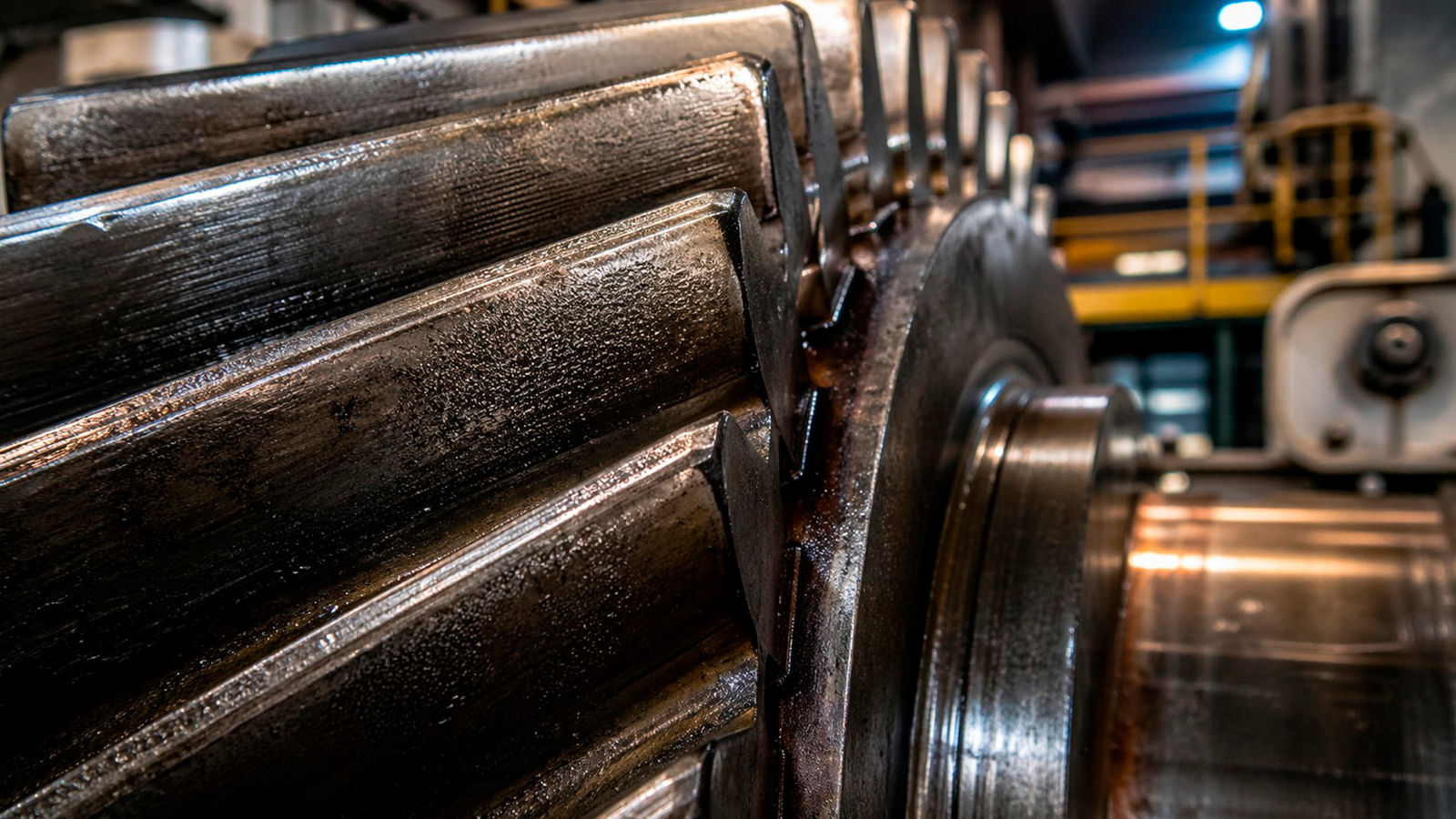

Figure 1—Early-stage surface fatigue and distress on a heavy-duty gear tooth flank. Surface damage may progress well before catastrophic failure becomes visible. (All Images: Pamilanga Ltd.)
In heavy industry, gears rarely fail in the dramatic way people imagine. More often, there is no broken tooth, no immediate seizure, and no single event that clearly marks the beginning of the problem. What appears to be a healthy gear may already be operating with edge loading, unstable lubrication film, progressive surface fatigue, or overload at the tooth root. By the time visible damage becomes obvious, the failure mechanism has usually been active for some time. This matters because plant decisions are still too often made at the component level. A gear is inspected, damage is found, and attention immediately shifts to material quality or OEM replacement. In practice, however, most serious gear incidents are system-driven. Alignment condition, shaft and housing stiffness, bearing clearance, lubrication regime, thermal growth, start-stop duty, shock loading, and maintenance response all influence the way the tooth pair actually carries load. Understanding that distinction changes not only how failures are diagnosed, but also how replacement strategy should be managed. Once a critical gear is out of service, the challenge is no longer purely technical. The question becomes how to restore reliability quickly, with controlled risk, and without accepting unnecessary dependence on long OEM lead times.
Failure Often Starts Long Before Fracture
Early-stage gear distress is typically progressive rather than catastrophic. Micropitting is one of the clearest examples. Under mixed or boundary lubrication, local asperity contact causes repeated surface fatigue at a very small scale. The damage may first appear as a dull grey patching effect on the active flank, usually near the pitch line or in areas where contact has shifted away from the intended load zone. Operators may continue running because the gear still looks serviceable and the machine has not yet tripped. But once the surface is disturbed, local stress concentration increases and the damaged area tends to grow.

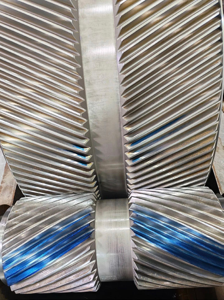

Figure 2 — Contact pattern verification on helical gear teeth. Blue marking compound highlights the actual contact area across the tooth flank. Uneven patterns may indicate edge loading, alignment deviation, or load distribution issues before visible gear damage occurs.
Figure 2 — Contact pattern verification on helical gear teeth. Blue marking compound highlightsthe actual contact area across the tooth flank. Uneven patterns may indicate edge loading,alignment deviation, or load distribution issues before visible gear damage occurs.
Scuffing is different in appearance and mechanism. It is associated with lubricant film collapse combined with sliding under load, often during transient events such as hot restarts, contamination, high bulk oil temperature, or inadequate viscosity at operating conditions. Instead of fine fatigue damage, the tooth shows tearing, smearing, and directional scoring. Bending fatigue, by contrast, develops from repeated tensile stress at the tooth root. If the effective load distribution across the face width is poor, root stress rises sharply at one side, and cracks may initiate from the fillet long before a full tooth breakage occurs.
The key lesson is that visible damage type is only the surface expression of the real operating condition. A gearset may show micropitting because the lambda ratio is too low for the actual duty, because the contact pattern has moved toward one edge, or because load spikes are repeatedly pushing the pair beyond its intended regime. A correct diagnosis, therefore, requires the gear to be viewed as part of a dynamic system, not as an isolated manufactured part.

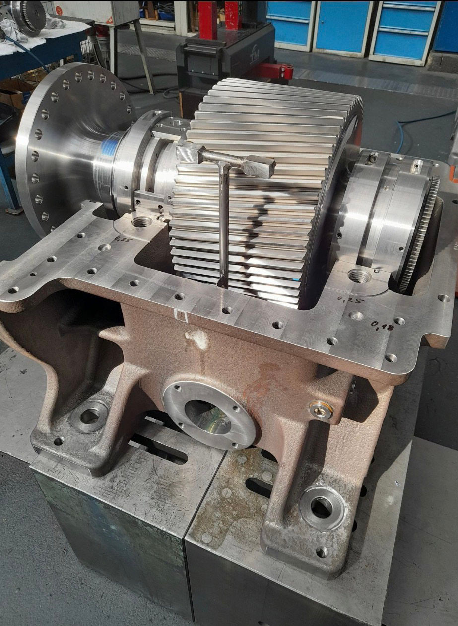

Alternative manufacturing should never mean copying a damaged part blindly. The process must begin with disciplined reverse engineering and qualification. First, the gear geometry needs to be captured correctly: module or diametral pitch, pressure angle, helix angle if applicable, face width, tooth count, profile modifications, root geometry, mounting interfaces, and any relevant fit or runout conditions. Three-dimensional scanning can help, but it is not enough by itself. Damaged or worn teeth can distort the digital picture, so direct measurement and interpretation by gear specialists remain essential.
Second, the material and condition of the original part must be understood. Depending on the component, this may include chemistry verification, hardness mapping, case-depth evaluation, microstructure review, and crack inspection. The objective is not simply to identify what the previous gear was made from, but to understand whether that specification was appropriate for the duty. In some cases, the best replacement is a like-for-like reproduction. In others, the better choice is to preserve geometry while improving process control, grinding quality, cleanliness, or heat treatment consistency.
Third, manufacturing route and inspection plan must be aligned with application risk. Blank production method, machining sequence, heat treatment route, flank finishing, balance if relevant, non-destructive testing, and final gear metrology all need to be defined before production begins. A qualified supplier should be able to show not only that it can machine a gear, but also that it can control lead error, profile error, pitch accuracy, hardness, and distortion across the full process. This is particularly important for large gears where heat treatment and final finishing introduce significant variability if not managed closely.
Finally, replacement planning has to include installation and startup discipline. Contact checking, alignment verification, lubrication readiness, controlled commissioning, and early inspection intervals are part of the replacement strategy not an afterthought. A technically correct gear installed into an unchanged misaligned train is still a vulnerable gear.
Figure 3 — Gearbox assembly under inspection. Heavy-duty gear and shaft assembly during fitting and inspection. Long-term reliability depends on evaluating the complete system rather than replacing the gear alone.
