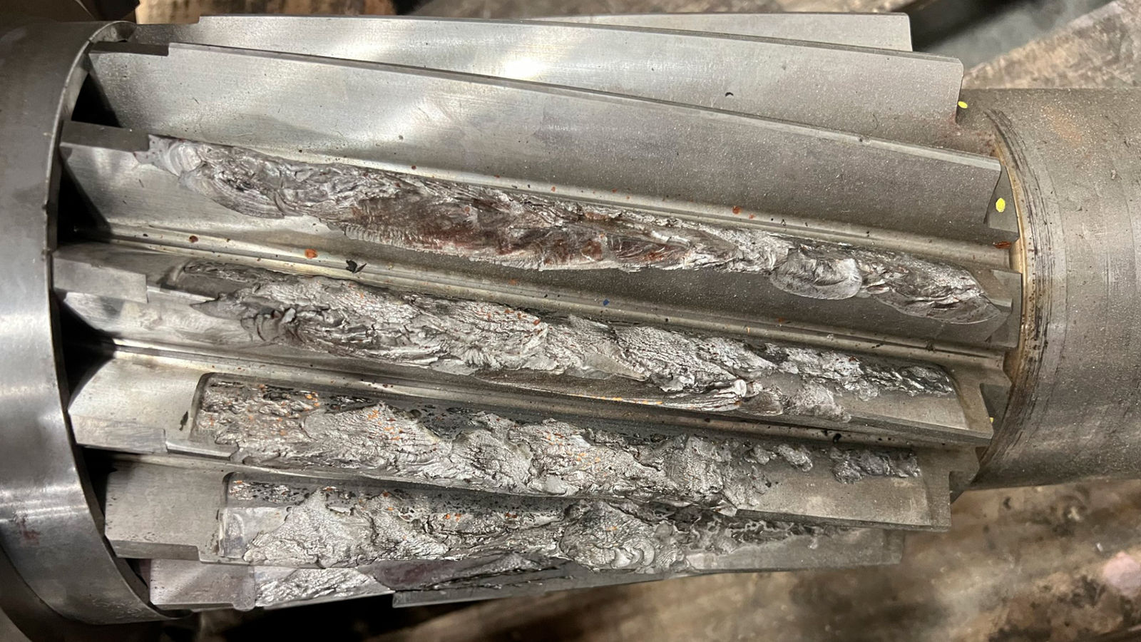

Case crush and tooth fracture on a helical pinion is the kind of damage that demands engineering analysis before anyone starts cutting replacement gears. (Image: Luftex)
