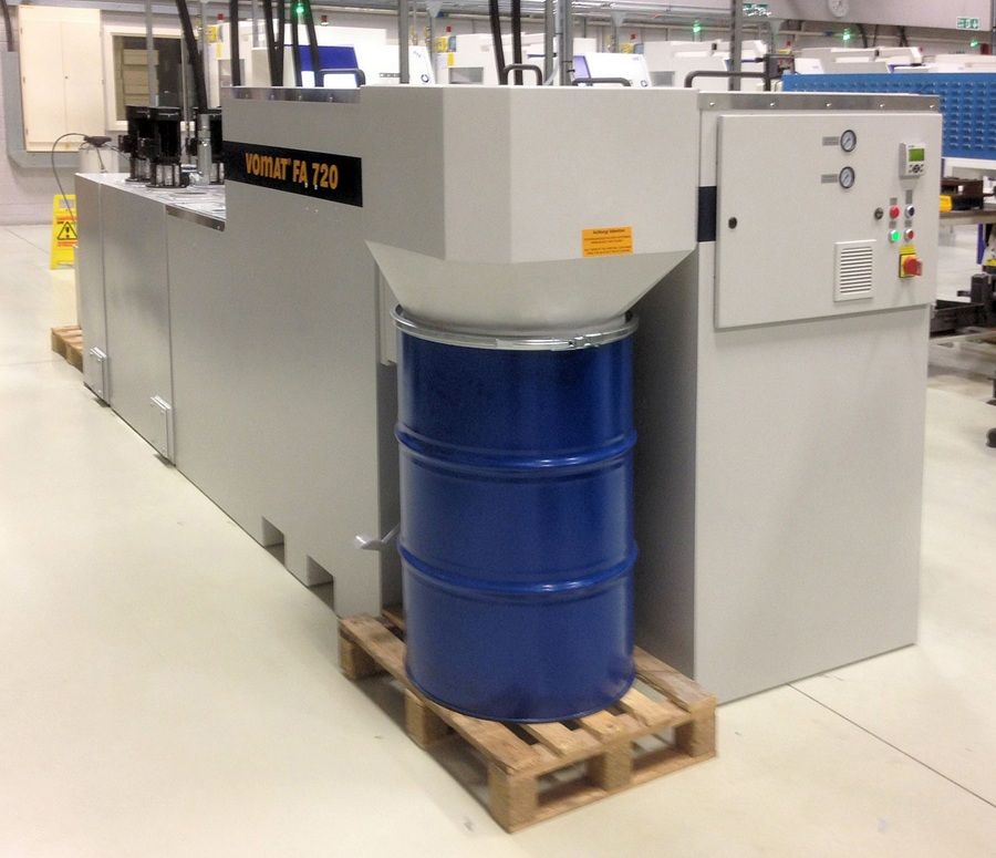

“In tool grinding, the condition of the cooling lubricant has a decisive influence on surface quality, dimensional accuracy, service life, and process stability. Fine particles from grinding abrasion, binder residues, or carbide dust act like grinding paste in the process: they deteriorate surfaces, increase tool wear, destabilize the process, and drive-up costs.
High-performance fine filtration of cooling lubricants should not be a secondary process. It is a fundamental factor in productivity and quality in tool grinding,” adds Strobel.
Vomat filters clean at full flow and separate dirty and clean oil 100 percent. This means that the user always grinds with pure cooling lubricant. To keep the filters clean, Vomat technology flushes them back as needed. To do this, the degree of contamination of each individual filter element is determined. Once a certain value is reached, the control system automatically initiates the backflushing process.
Meanwhile, the other filter elements continue to ensure a continuous and complete supply of clean oil with a purity level of 3–5 µm. This fully automatic control and regulation of the
filter capacity keeps energy and operating costs low. In addition, Vomat technology controls the temperature of the cooling lubricant medium within a range of ±0.2 K during the grinding process.  With special concepts for recycling and reprocessing, the recyclable material can be collected directly in the recycling company’s collection container and then disposed of and reprocessed in a cost-optimized manner.
“With intelligent, energy-efficient microfilter systems, Vomat pursues a holistic approach to cooling lubricant management. The systems are modular in design, can be integrated close to the process, and are designed to keep the cool-ing lubricant in optimal condition at all times—regardless of the material, grinding strategy, or batch size. They thus make a decisive
contribution to stable processes, lower operating costs, and reproducible tool quality. As co-sponsor of the GOTY 2026 competition for young talent, we emphasize the importance of a  clean, stable, and intelligently managed cooling lubricant system for excellent grinding results, while at the same time sending a clear signal for the promotion of young talent and process thinking,”
