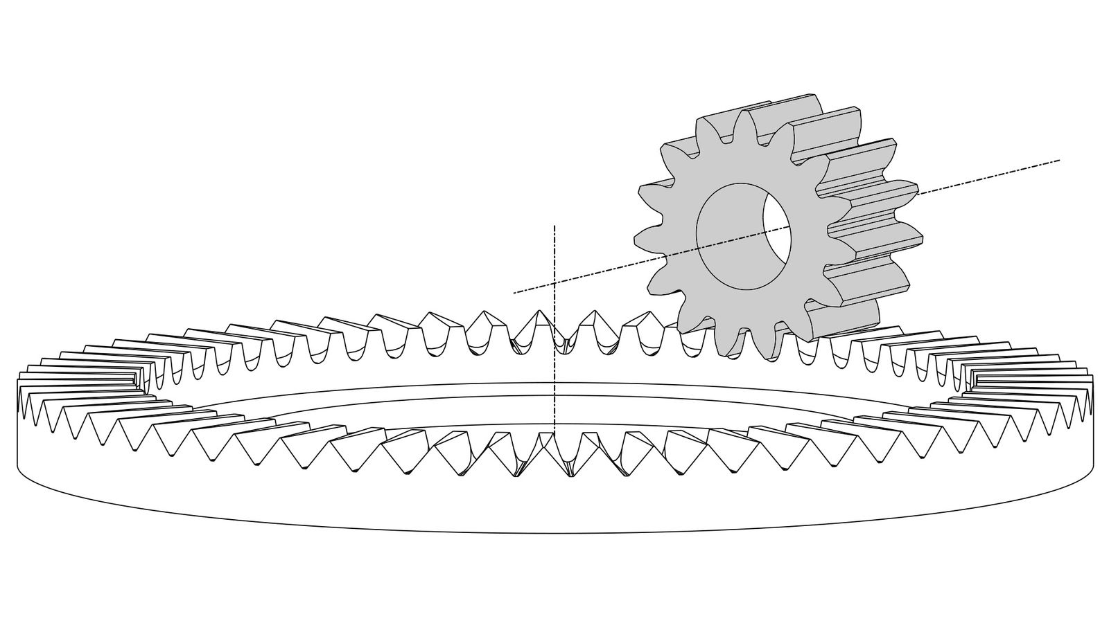

Figure 2—Exemplary face gear drive. Pinion in gray and face gear in white. Reprinted from Ref. 8.

Face gear drives are a special type of angular gear unit, in which an involute pinion meshes with a face gear wheel (Refs. 24, 25). The pairing can be helical and with or without center offset. Figure 2 shows an exemplary spur face gear drive configuration without center offset. The pressure angle of the face gear wheel is variable across the tooth width and increases towards the outside radius (Refs. 26, 27). One advantage of face gear drives is that both gearings can be manufactured on conventional cylindrical gear machines, and the contact pattern in the axial direction of the pinion does not need to be adjusted (Ref. 25).
However, the comparison of the gear geometries in Figure 2 leads to the conclusion that the approaches for calculating the gear body stiffness of cylindrical gears cannot represent the deformation state of face gear wheels. Due to the plane shape of the face gear wheel, it is to be expected that the deformation increases in the direction of the outer radius. As a result, the stiffness of the gear body decreases toward the outer radius. This work aims to develop a basic model for calculating the gear body stiffness of face gear wheels based on mechanical analytical approaches.

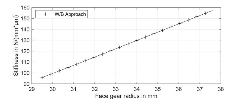

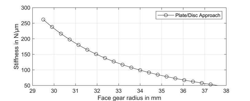

The validation of the methods described for calculating plate and disc deformation using the Fourier series approach is included in the conference paper (Ref. 28). In addition, the corresponding conference paper contains an analysis of the influence of the Fourier series parameter j on the convergence of the partial work integrals.
The aim is to develop a method for gear body stiffness for face gear wheels. Using the method from the “Face Gear Wheel Body Stiffness Calculation” section, this is possible along the tooth width (face gear radius). For the calculation, it is necessary to split the force P at the contact point into the individual force components (normal, bending, shear, and radial). Usually, the force components and directions (pressure angle) result from a load-free tooth contact simulation. For spur face gear drives (β=0), the pressure angle can also be approached from the model of the curved gear rack (Refs. 26, 27):
(28)
Herein, mn is the normal module, z is the face gear teeth number, and an is the normal pressure angle of the pinion/cutter. The relationship thus gives the face gear pressure angle along the tooth width (radius r). The force/moment components result from the equations according to W/B in the “Introduction and Motivation” section. The radial force component is zero for spur face gears (Ref. 51). The W/B approach is essentially a 2D model of a plane with different loads on the boundary. To determine the stiffness across the tooth width with variable pressure angle, the gear tooth is divided into single slices (thin-slice model). With the previous equation, it is obvious that the pressure angle α' increases over the face gear tooth width. W/B applied to each single slice results in the gear body stiffness curve in Figure 7. The stiffness curve shows almost linear behavior. Due to the slice model, the stiffness is related to the slice thickness and given per unit face width. The unit N/(mm*μm) is chosen according to ISO 6336 (Ref. 16). The stiffness for the slice model is normalized to the slice thickness, as it changes with the thickness. Due to normalization, the curve in Figure 7 is independent of the number of slices (slice thickness). Figure 7 clearly shows that—when the method according to W/B is applied directly—the gear body stiffness increases along the tooth width. The deviation of the stiffness between the outer and inner radius for the W/B approach is:
(29)
Figure 7—Gear body Stiffness along the face gear radius (tooth width), derived using the W/B method in single slices (yp =1 mm ). Tooth root width for W/B b=2frf.
Figure 8—Gear body Stiffness along the face gear radius (tooth width), derived using the proposed method in this work (yp =1 mm).
Figure 8 shows the gear body stiffness curve along the tooth width, determined using the method proposed in this work. Since the plate/disk approach is no longer a thin-slice model and the gear body stiffness is determined on the full model for discrete radii between the inner and outer radius of the teeth, the stiffness cannot be normalized to the slice thickness. This results in the unit N/μm. A qualitative comparison with the W/B method is therefore possible. In contrast to the W/B method in Figure 7, the gear body stiffness curve in Figure 8 shows a decreasing behavior. It is also evident that the curve does not show linear growth. The deviation of the stiffness between the outer and inner radius for the plate/disk approach is:
