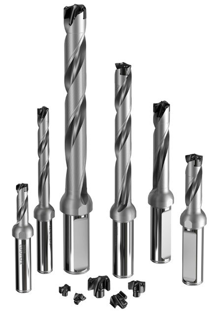

Featuring a replaceable carbide tip, tool changes can take place faster without needing to remove the drill body from the holder.

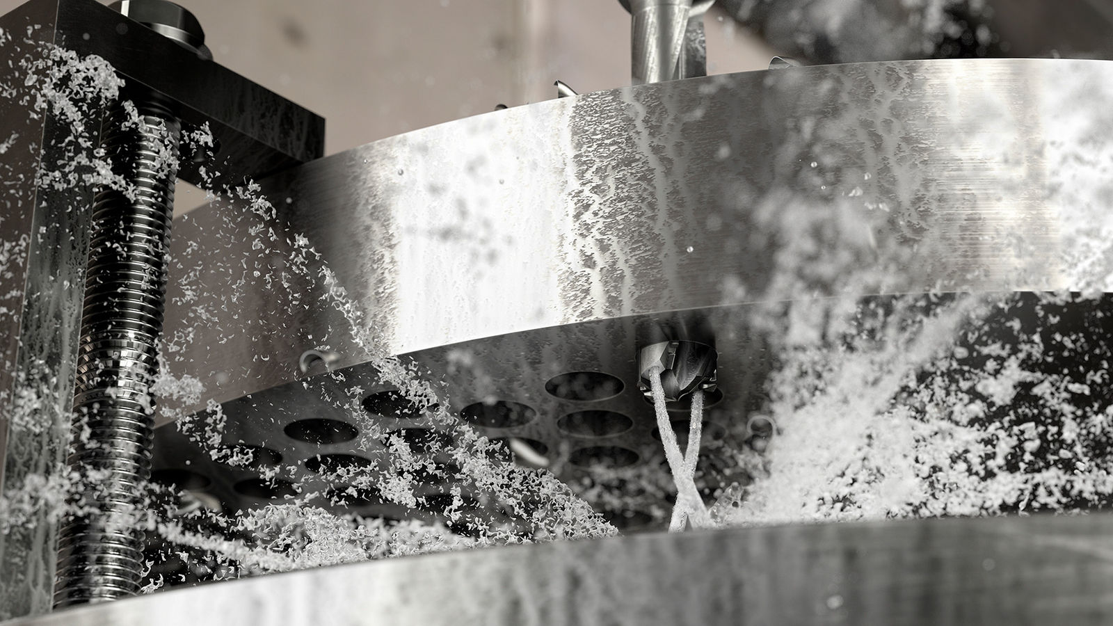

The overall machining setup plays a critical role in ensuring process stability, tool life, and part quality in gearbox and blank machining and directly impacts the overall machining result. For short- to medium-depth drilling, especially in alloyed or cast materials common to gearbox housings, moderate to high feed rates and cutting speeds are typically used to maintain productivity. However, stability and chip evacuation must be carefully balanced.
Excessive speed can lead to heat buildup and premature tool wear, while an insufficient amount of speed can result in poor chip formation, something that can lead to serious consequences such as increased tool wear, poor hole quality, and possible chip jamming. Coolant plays an integral role in alleviating issues with chip jamming, and an optimized chip flute geometry with twisted coolant holes encourages good chip evacuation.
Using internal coolant supply at pressures between 145–436 psi (10–30 bar) is generally recommended, particularly in blind or interrupted holes, to promote reliable chip evacuation and minimize heat transfer to the workpiece. Emulsion-based coolants are most common for steel and cast iron, though some shops may use straight oils for improved surface finish in critical sealing surfaces or alignment bores.
When drilling components such as gear housings and gear blanks requiring tight positional tolerances, exchangeable drill tips can give manufacturers better process stability while lowering overall tooling costs.

Selecting the right drilling tool is pivotal to overcoming the challenges of high-volume holemaking in gear production and to achieving consistent, high-quality results. The ideal drill must balance accuracy, durability, and productivity, especially in high-output environments where even small improvements can yield significant cost and time savings.
When drilling in high volumes, exchangeable-tip drills can offer a highly efficient solution. Featuring a replaceable carbide tip, tool changes can take place faster without needing to remove the drill body from the holder. In addition, some exchangeable-tip drills are designed to alleviate the need for pilot holes or pre-setting equipment, thereby drastically reducing cycle times and minimizing the reliance on operator intervention.
An exchangeable-tip drilling strategy can reduce downtime, simplify inventory in busy machine shops and ensure more consistent hole quality. When drilling components such as gear housings and gear blanks that demand tight positional tolerances, using exchangeable drill tips gives manufacturers better process stability while lowering overall tooling costs.
When considering exchangeable-tip drills, it’s important to evaluate the clamping interface. Choose one that enables fast and easy tip changes without spare parts, ensures reliable drilling at high feeds and speeds, and delivers superior clamping strength. This will help you achieve straighter holes with tighter tolerances. It also extends drill body life for a more robust exchangeable-tip drill.
Some exchangeable-tip drills, like Sandvik Coromant’s CoroDrill DE10, are designed to eliminate the need for a pilot hole, thereby drastically reducing cycle times.
