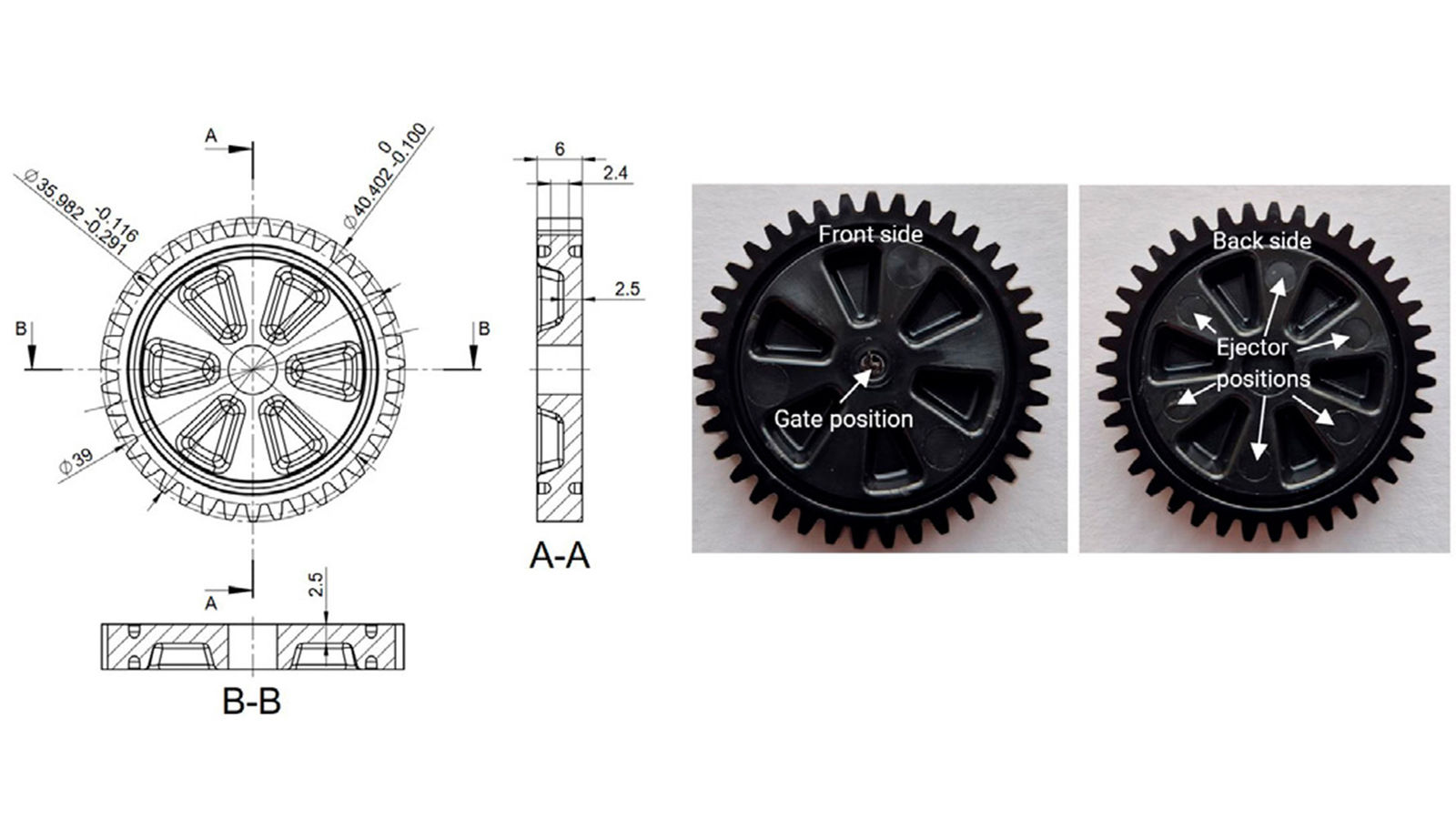

Sample Preparation
The test gears were fabricated via injection molding using a single-cavity mold. Molding operations were conducted on an Engel Victory 50 injection molding machine (Engel Austria GmbH, Austria). A three-plate mold configuration incorporating a hot-runner system and a centrally positioned pin-point gate with a 1.3 mm diameter was employed. Gear geometry conformed to the specifications outlined in VDI 2736, Part 4, Table 1, corresponding to Size 1 geometry (Ref. 9). The gear body was engineered with a wavy structural design, maintaining a consistent wall thickness of 2.5 mm (Figure 1). A symmetric groove was integrated at the interface between the gear body and tooth region to promote uniform material flow and complete cavity filling during the molding process.
Figure 1—Plastic gear samples employed for the testing procedures.

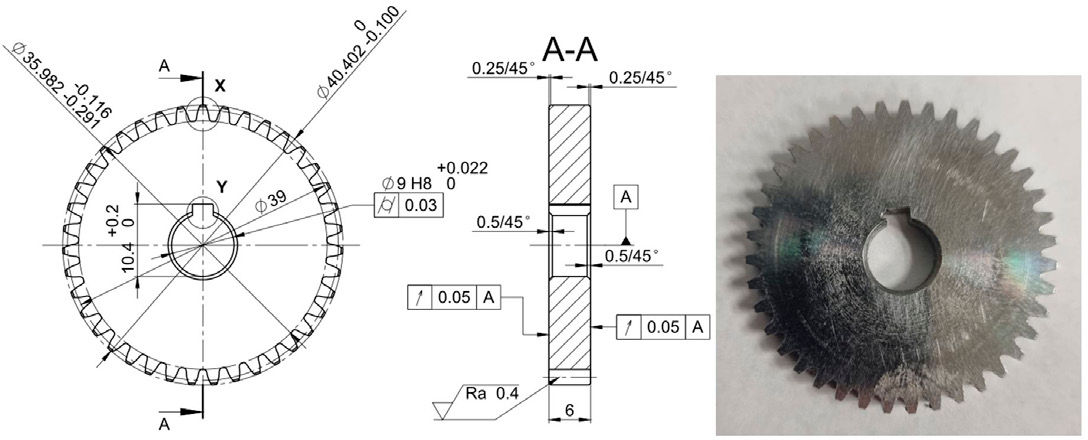

As a reference for comparative analysis, three sets of steel gears were fabricated from heat-treated 42CrMo4 alloy, maintaining identical gear geometry as specified in Table 1. Steel gear specifications are shown in Figure 2.
ParameterNomenclatureUnitValue
Centre distanceamm38.45
Normal modulemnmm1
Face widthbmm6
Number of teethz1/z2/39
Tip diameterda1max/da1minmm40.40/40.30
da2max/da2minmm40.40/40.30
Root diameterdf1max/df1minmm35.866/35.691
df2max/df2minmm35.866/35.691
Tip roundingrK1 / rK2mm0.08
Profile shift coefficientx1/-0.259
x2/-0.259
Pressure anglean°20
Helix angleb°0
Profileh*aP/0.96/0.96
h*fP/1.25/1.25
t*fP/0.25/0.25
Figure 2—Steel gear samples employed for testing.

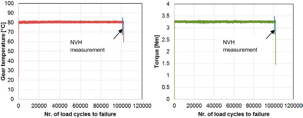

Figure 4—The gear’s temperature and the transmitted torque were precisely controlled during each test. NVH measurements were done when 105 load cycles were reached.
Figure 4—The gear’s temperature and the transmitted torque were precisely controlled during each test. NVH measurements were done when105 load cycles were reached.

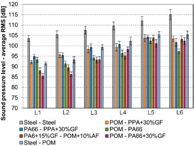

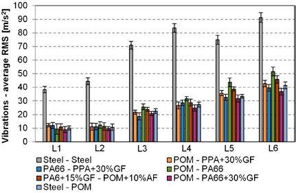

The mean RMS values of the sound pressure levels are presented in Figure 8, while the corresponding RMS values of the measured vibrational signals are shown in Figure 9. These results represent the arithmetic average of three independent test repetitions conducted under each operating condition, with error bands denoting one standard deviation to reflect variability in the measurements. For the benchmark steel gear pair, a relatively linear increase in sound pressure level was observed with rising torque and rotational speed. In contrast, the polymer gear pairs demonstrated a more complex and nonlinear acoustic response to changes in operating parameters. Notably, the steel gear pair consistently produced sound pressure levels approximately 10 dB higher than those of the noisiest polymer gear combination. Within the polymer gear group, a sound pressure level differential of approximately 10 dB was recorded between the highest and lowest performing material combinations at the lowest tested rotational speed. As rotational speed increased, a corresponding rise in sound pressure levels was observed. However, at the highest rotational speed, the variation in noise emissions across the polymer gear combinations diminished significantly. It is important to highlight that a sound pressure level difference of approximately 3 dB is typically considered the minimum perceptible threshold for the average human listener. Differences below this value, particularly at absolute levels exceeding 100 dB, are generally imperceptible under normal auditory conditions.
Figure 8—Sound pressure level, measured for the tested gear pairs. The temperature of plastic gears was controlled at 80°C in all tests (temperature measured on the teeth).
Figure 8—Sound pressure level, measured for the tested gear pairs.The temperature of plastic gears was controlled at 80°C in all tests(temperature measured on the teeth).
Figure 9—Vibrations, measured for the tested gear pairs. The temperature of plastic gears was controlled at 80°C in all tests (temperature measured on the teeth).
Figure 9—Vibrations, measured for the tested gear pairs. The temperatureof plastic gears was controlled at 80°C in all tests (temperaturemeasured on the teeth).
It is important to underscore that all gear pairs were evaluated within an acoustically isolated chamber, ensuring that the recorded acoustic signals originated solely from the gear pair under test. In practical gearbox applications, however, the dominant source of radiated noise is typically the gearbox housing. This noise arises primarily from structural vibrations induced by the meshing gears, which are transmitted to the housing through the shafts and bearing interfaces. The RMS vibration values measured for the steel gear pairs were, in certain cases, more than double those observed for the polymer gear combinations. This substantial increase in vibratory energy suggests that gearboxes employing exclusively steel gears are inherently predisposed to higher acoustic emissions, due to more pronounced excitation of the housing structure.
All material pairings were evaluated under identical operating conditions, including fixed torque, rotational speed, and actively controlled gear temperature. Nevertheless, the dynamic (modal) characteristics of the gear pairs varied due to differences in material density and stiffness. Consequently, the natural frequencies (eigenfrequencies) of each gear configuration were located at distinct positions within the frequency spectrum. For instance, the steel–steel gear pair exhibited eigenfrequencies that differed not only from those of the polymer–polymer pairs but also among the various polymer–polymer combinations themselves. When a mechanical structure is excited at or near one of its eigenfrequencies, it responds with significantly amplified vibration amplitudes—ideally exponentially approaching resonance. As a result, a specific material combination may exhibit elevated vibrational levels at one operating speed while demonstrating reduced response at another, depending on the excitation frequency relative to its modal properties. This phenomenon has practical relevance, as real-world gearboxes frequently encounter fluctuating loads and speeds. To verify that the observed NVH responses originated specifically from gear meshing and were not influenced by ancillary noise sources such as motor emissions, bearing noise, or environmental interference, fast Fourier transform (FFT) analysis was applied to both the vibration and acoustic signal datasets. It was critical to confirm that the dominant spectral peak in all analyzed signals corresponded to the gear meshing frequency. As illustrated in Figure 10, this criterion was met, thereby validating that the recorded NVH characteristics were attributable solely to the dynamic interaction of the meshing gear pair.

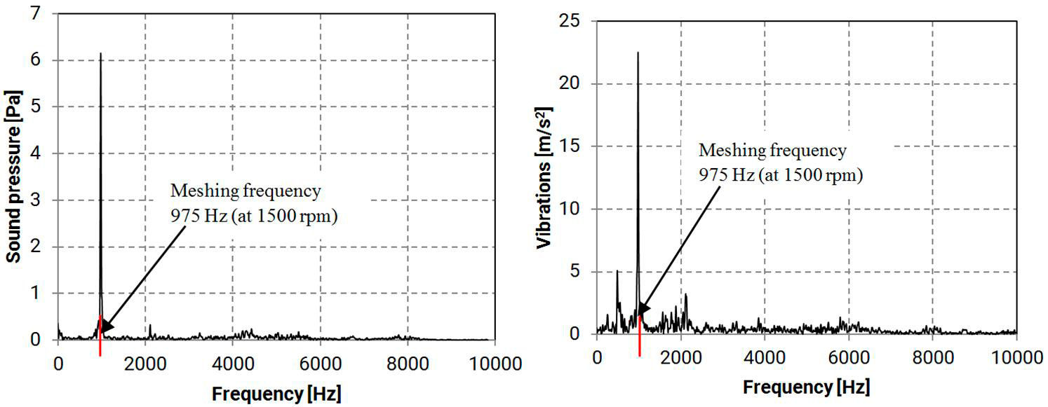

Figure 10—FFT of the measured vibrations and sound pressure signal. The rotational speed of the test was 1,500 rpm.
The superior NVH performance of steel–polymer and polymer–polymer gear pairs arises from a combination of physical and material-specific properties. First, polymers have a lower elastic modulus than metals, which reduces contact stiffness during meshing. This softer interaction lessens impact-induced excitation and enables smoother load transmission, thereby lowering the intensity of impulsive noise. Second, polymers possess much higher material damping than metals, allowing vibrational energy to dissipate as heat rather than propagate through the system. Their lower mass and density further decrease inertial forces, which helps minimize excitation amplitudes and structure-borne noise. In addition, the conformability of polymer gear teeth enhances load distribution, reduces localized stress concentrations, and limits micromechanical impacts, all of which contribute to quieter operation. Finally, favorable tribological characteristics—such as reduced stick-slip tendency due to lower friction coefficients—help suppress high-frequency vibrations and tonal noise components. Collectively, these factors lead to a marked reduction in both sound pressure levels and structural vibrations.

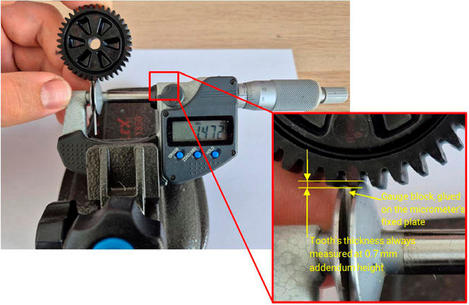

Wear was quantified based on the reduction in chordal tooth thickness. To ensure measurement consistency, the chordal height specific to the gear geometry was first established. A customized Mitutoyo micrometer screw gauge equipped with round anvils was utilized for the chordal thickness measurements. The chordal addendum was fixed at 0.7 mm from the tooth tip, using a gauge block affixed to the stationary anvil of the micrometer (Figure 11), thereby standardizing the measurement location across all test intervals. To eliminate variability due to gear positioning, all intermediate wear measurements were conducted with the gears mounted on the test bench, preserving a constant center distance throughout the testing campaign. For each gear, four representative teeth, uniformly distributed along the circumference, were marked and used for repeated measurements. Final wear measurements were performed after the gears were removed from the test rig. Figure 12 illustrates the correlation between progressive wear and NVH behavior. Over the test duration, the sound pressure level increased by an average of 6 dB for the POM–PA66 gear pair and 4 dB for the Steel–POM combination. Concurrently, the RMS vibration amplitude rose from 21 m/s² to 45 m/s² for the POM–PA66 configuration and from 18 m/s² to 38 m/s² for the Steel–POM pair. This increase in vibrational response is attributed primarily to elevated transmission error induced by gear wear. Černe et al. (Ref. 11) previously characterized this phenomenon through numerical simulation, reaching comparable conclusions.
Figure 11—Wear measuring method—measured is the reduction in tooth thickness at the selected addendum height.
Figure 11—Wear measuring method—measured is the reduction in tooth thickness at theselected addendum height.

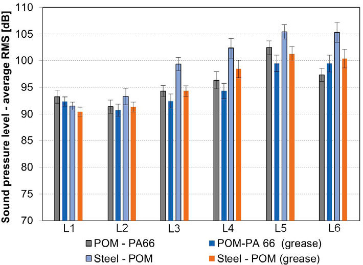

A comparative analysis of the measured sound pressure levels for dry and grease-lubricated conditions in Steel–POM and POM–PA66 gear pairs is presented in Figure 13, with corresponding vibration levels summarized in Figure 14. While differences at the lowest tested rotational speed were relatively minor, a marked improvement in NVH performance was observed at intermediate (L3, L4) and high (L5, L6) speed levels under lubricated conditions.
Figure 13—Comparison between measured sound pressure level for dry-run and grease-lubricated tests.
Figure 13—Comparison between measured sound pressure level for dry-run and grease-lubricatedtests.

Overall, the application of grease exhibited a beneficial effect, acting as an additional damping medium within the gear tooth contact zone. This led to a reduction in impact-induced noise and vibration, as well as a suppression of stick-slip phenomena. The improved dynamic response is attributed to the lubricating film’s capacity to mitigate direct surface interactions and absorb vibratory energy during meshing. In between measured sound pressure level for dry and grease lubricated tests with Steel–POM and POM–PA66 combinations are shown in Fig. 13. Measured vibration levels are summarized in Fig. 14. While at the lowest tested rotational speed the differences were not so evident a quite significant improvement could be observed at the medium (L3, L4) and high (L5, L6) rotational speeds. In general, a beneficial impact of grease could be observed, which can be considered as an effect of an additional damping element in the contact, generating less impact noise and vibrations, while also reducing the stick-slip effect.

  1. Plastic gear pairs exhibited substantially better NVH characteristics than steel gears. Sound pressure levels were reduced by up to 10 dB, while vibration levels decreased by more than 50% in some cases, underscoring their potential for noise-sensitive applications.
  2. Among the tested pairs, POM–PA66+30%GF gears achieved the best NVH performance, benefiting from higher meshing stiffness and lower transmission error. In contrast, the POM–PA66 pair showed the highest vibration levels among plastic gears, linked to lower stiffness and greater transmission error.
