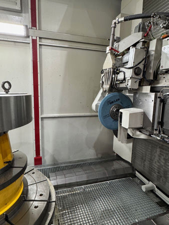

Atlanta Gear Works saw a 30 percent efficiency boost and 50 percent fewer interruptions (eliminated wheel adjustments) with Weiler’s grinding wheel. (Images: Weiler Abrasives)

In the past, grinding wheel delivery for AGW took 16 weeks to process. Weiler Abrasives delivered their wheels in weeks instead of months, customized and matching the exact specifications for AGW’s gearbox needs. On-site analysis and collaboration led to a custom-designed grinding program fit specifically to the exact applications.
After the change in grinding wheels, Atlanta Gear Works saw a 30 percent efficiency boost (8 hours saved per part) and 50 percent fewer interruptions (eliminated wheel adjustments). Brown credits similar engineering philosophies between Weiler and Atlanta Gear Works as critical to the collaboration.
Potential swarf build up was a concern with the new tooling. Weiler worked with AGW’s engineering team to ensure the swarf would not clog the drains or flood the floor. The size of the chips coming off the machine were no different from previous setups with the new grinding wheel.
Another challenge was making sure grinding burn (discoloration, cracking, or tempering caused by excessive heat) was prevented. The Weiler team formulated a wheel that reduced the risk for burning while maximizing form holding.

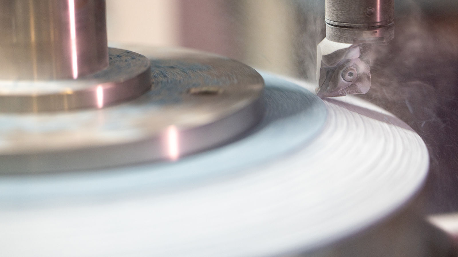

Cutting grains used in bonded abrasive gear grinding wheels include aluminum oxide, silicon carbide, zirconia alumina and ceramic alumina. Typically, grains are based on the materials being cut, the buildup of heat and the costs. Some grains are much more aggressive and provide faster cutting combined with just the right bonding technology.
“The reason our technology works so effectively is because we were able to have as little bond on the wheels as possible and the most grain to cut and remove material,” Brown added. “If you have the right bond system, you’ll have a positive impact on the wheel’s lifespan as well as its cutting rate.”
The advanced formulation of V59 bond technology provides superior grain retention, improving wheel life and grinding efficiency.
Harder bonds typically have a longer lifespan and are better for softer materials, while softer bonds have a shorter lifespan but shed grains more quickly, providing a faster cut.
Weiler Abrasives’ V59 bond technology, for example, ensures exceptional results and addresses customers’ unique needs with flexibility and precision. The advanced formulation of V59 bond technology provides superior grain retention, improving wheel life and grinding efficiency. Dynamic porosity lowers grinding temperatures through increased coolant efficiency and greatly reduces part surface damage from heat distortion while aiding in material removal rates — allowing for a reduction in grinding cycle times. The extended wheel life delivered with V59 bond technology also improves profile retention and reduces dressing frequency.
