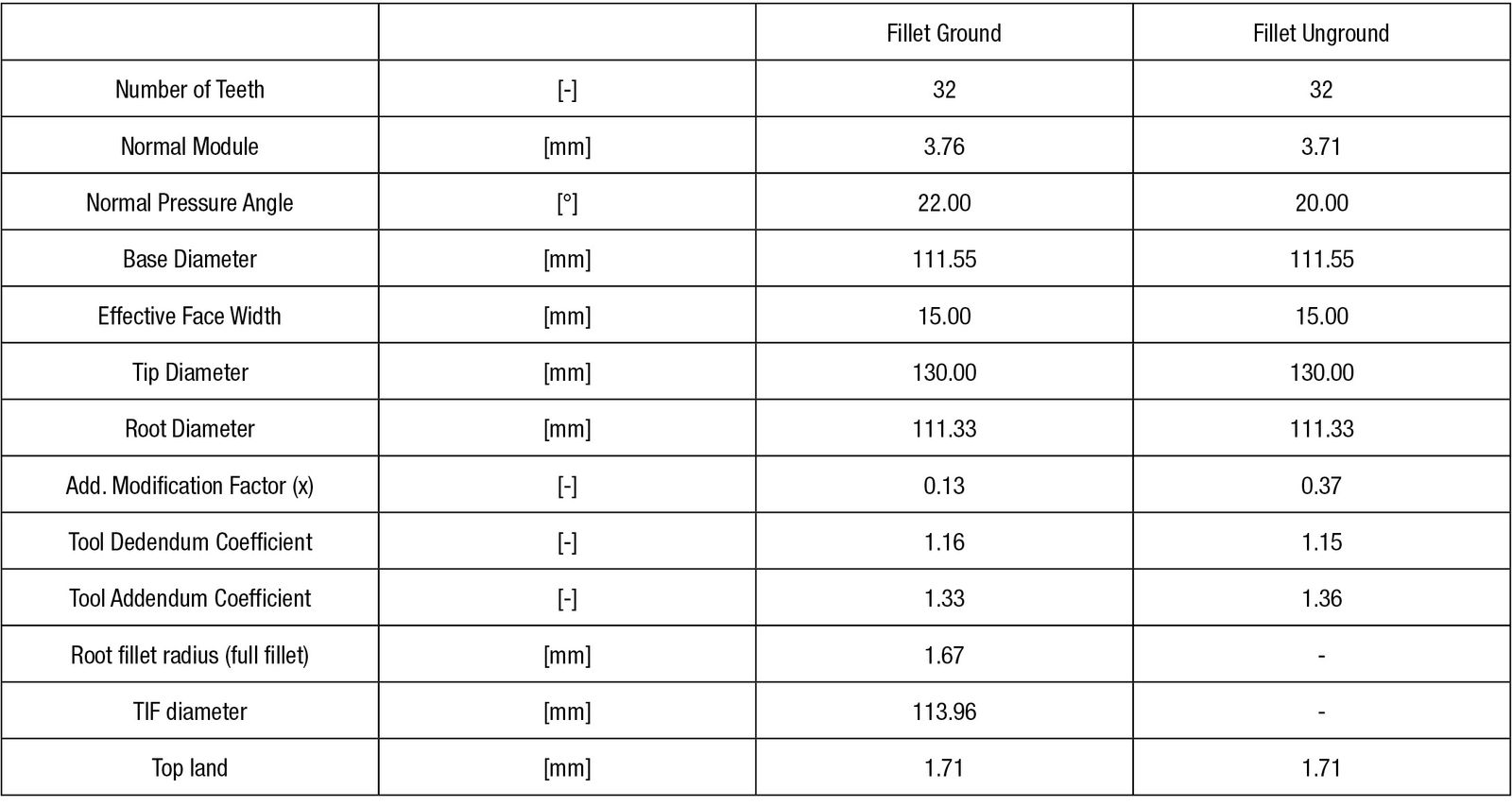

All the above requirements lead to the definition of the spur gear geometries reported in Table 1. The gears have 32 teeth, and the number of teeth considered for the span measurements was set to 5. As a result, each gear specimen allows for the extraction of eight testable pairs of teeth.
Table 1—Spur gear geometries.

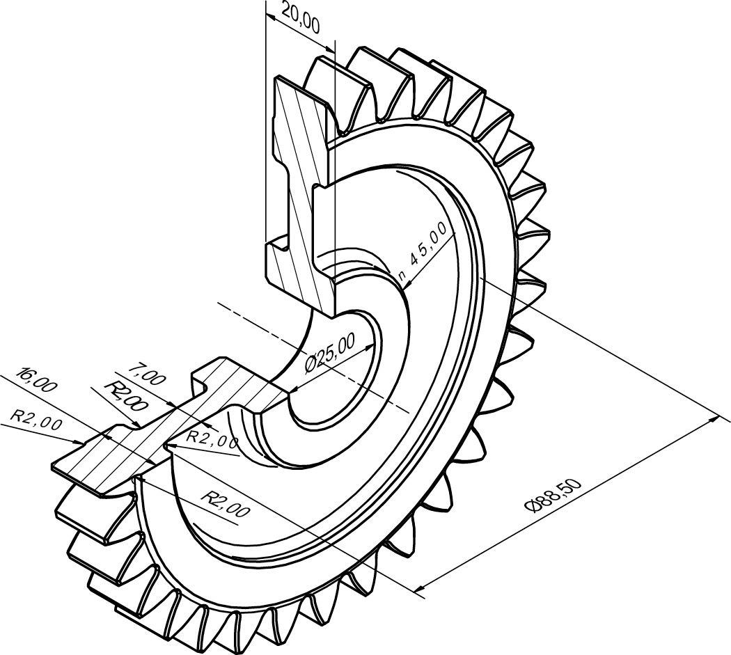

The adopted gear specimens completely follow the production cycle of Leonardo. Hence, all gears present ground flanks. The difference between the two geometries is related to the possibility of having or not having a ground tooth root, depending on the different manufacturing processes. That is, the “Fillet Unground” geometry has a tooth root whose actual profile is produced during the tooth generation process, while the “Fillet Ground” root is manufactured using form grinding.

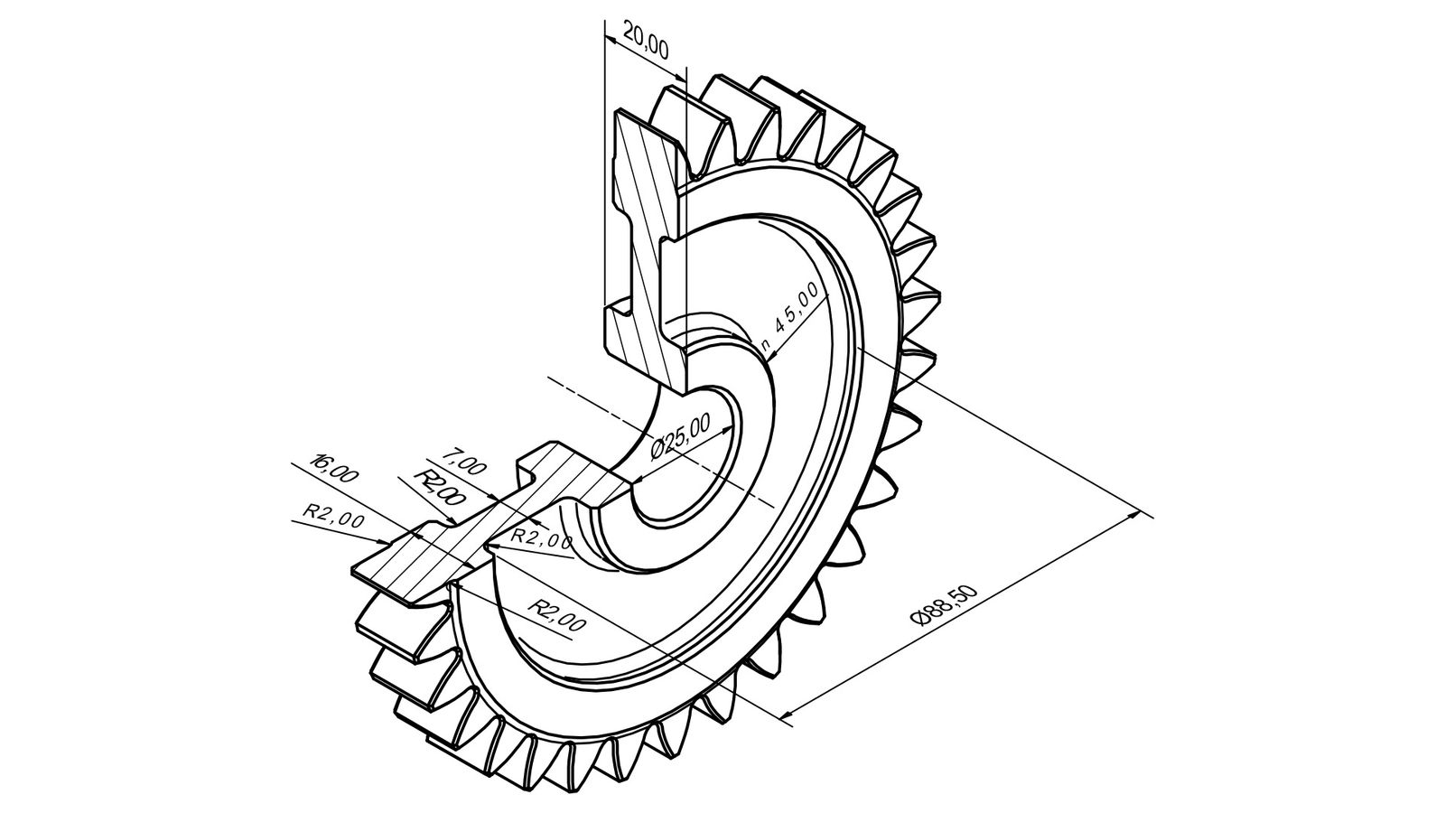

Furthermore, the adopted geometry incorporates features representative of practical applications, as shown in Figure 1. For instance, a thin rim—characteristic of lightweight gear designs—was included with proportions consistent with typical helicopter industrial practice. Another example is lateral fillets, which reduce stress at the base of the tooth.
Figure 1—Isometric section of the specimen with some dimensions highlighted.

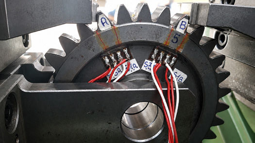

Pulsator tests are completed with various related activities. The first, carried out at the beginning of each test batch, involves the use of a strain-gauged gear to verify the alignment of the machine, checking that the machine provides a well-distributed state of stress along the root width. The information provided by this gear, shown in Figure 4, has also been used to verify the validity of the developed FEM models (e.g., Refs. 3, 6). Other related activities are aimed at evaluating the material from a more metallurgical point of view, such as SEM analysis of fracture surfaces to investigate the origin of the fracture (e.g., Figure 5), and microhardness profile analysis (e.g., Figure 6).
Figure 4—Strain-gauged gear for alignment verification.

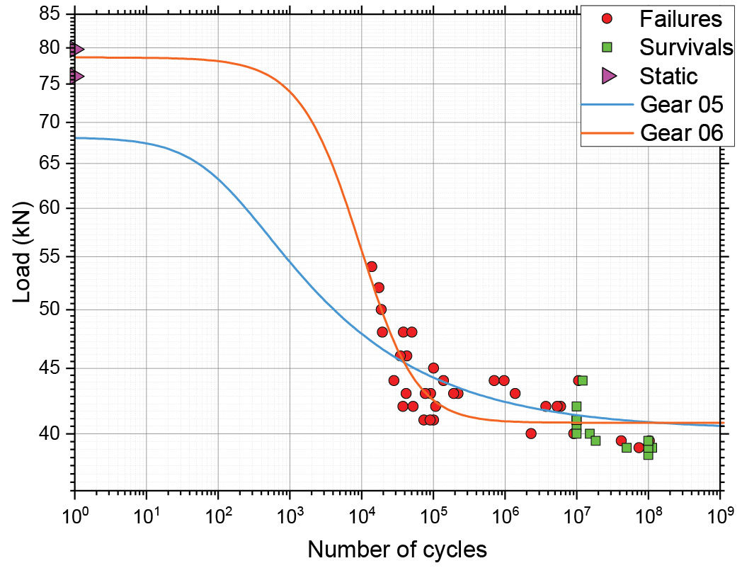

The aim of each experimental campaign is the definition of a continuous function that characterizes the complete S-N curve, ensuring a seamless representation across all fatigue life regions. According to the design procedure adopted by Leonardo, a continuous curve defined according to the following analytical equation has been used:
(1)
where S is the stress, N the number of cycles, SL the fatigue limit, and H, A, B and C are constant.
Depending on the constants introduced, different trends can be obtained. In the first phase, several shapes have been considered based on previous experiences of Leonardo to understand which were more suitable to fit the experimental test data on gears. Eventually, one of those, named GEAR05, has been selected. The selection of the most suitable curve has been done based on the minimum value of the coefficient of variation (CV), i.e., the ratio between standard deviation and mean, of the fatigue limit predicted by each of them. One more shape curve, named GEAR06, has been defined during the present research program, with the scope of enabling the fitting capability in the region of fatigue strength, and of obtaining CV values lower than those of the already available curves.
Therefore, the constants of the GEAR06 curve have been determined by means of a minimization procedure of the CV, for each of the families considered in the research program. In this context, CV is also used to evaluate the robustness of the single tested family.
In the definition of the GEAR06 curve, the ultimate strength of the tooth is also considered. In this way, a strong correlation between the fitted curve and the experimental data in the low-cycle fatigue regime is provided. In any case, this does not mean that the curve is meant to be applied in the low-cycle fatigue region, where a strain-based approach should be used instead of the stress-based one, which is limited to the high-cycle fatigue region.
This paper is not focused on discussing the differences among the different shapes of the S-N curve, and for this reason, the results of the single families of materials are presented in terms of the GEAR06 curve only. Nevertheless, a summary in terms of the GEAR05 is also included.
The parameters are estimated by means of a minimization procedure in which, for mathematical reasons, tests that did not end with a failure (i.e., the runouts) are considered as failures. At the earliest stages of this long-term research project, some very-high-cycle (i.e., ≥108) pulsator tests have been conducted to verify that the proposed curve properly represents the root lifetime at a very high number of cycles; that is, to verify the presence of the horizontal asymptote represented by the fatigue limit. Figure 7 shows an example of the estimated curve together with the experimental points.

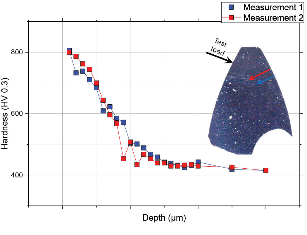

Figure 6—Example of a hardness profile as a function of depth.
Figure 7—Example of estimated curves.

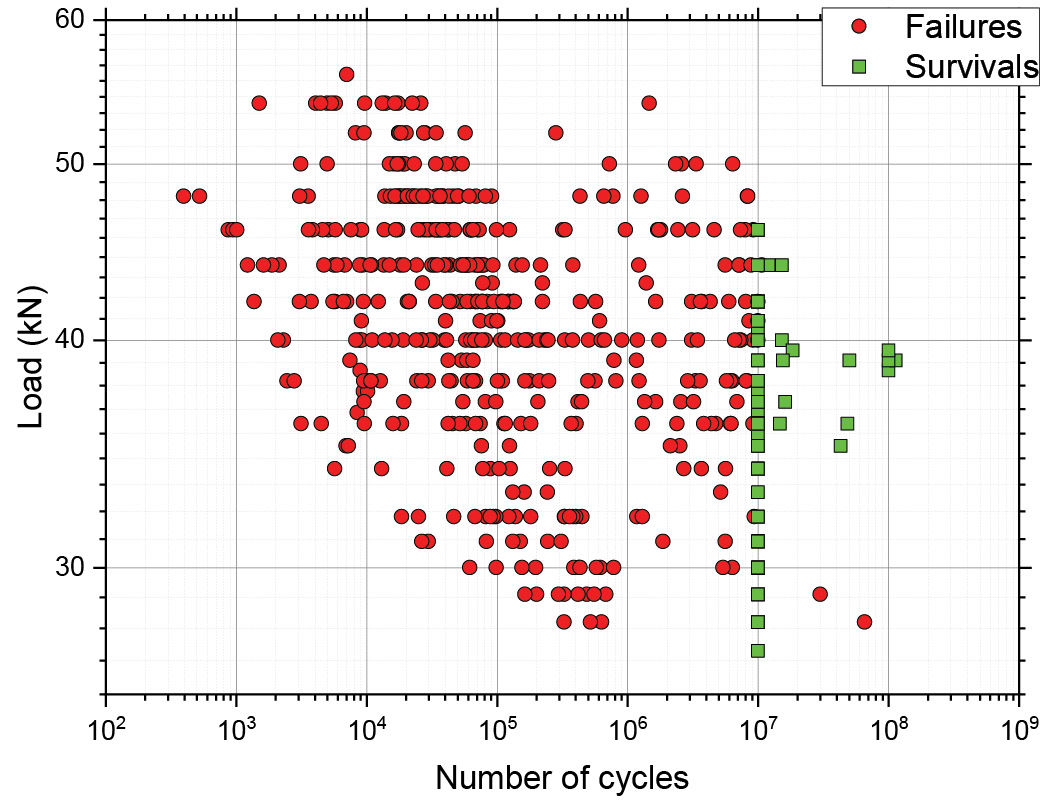

More than 650 fatigue tests have been performed in these 20 years, for a total number of cycles of 3.13 billion load cycles, which corresponds to a machine time of almost 3 years. Figure 8 reports all those data points. Among the tested families, the application of isotropic superfinishing to the root with two different processes (i.e., REACH-compliant and non-REACH-compliant) to gears in AISI 9310—shot peened—did not result in curves that are statistically different. Therefore, both families have been merged into a unique one (i.e., 9310 VIM-VAR – SP+ISF)
Figure 8—Fatigue data overview.

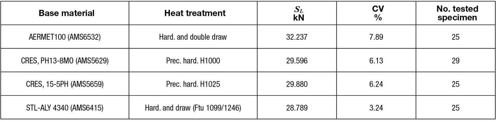

Table 5—Other families.

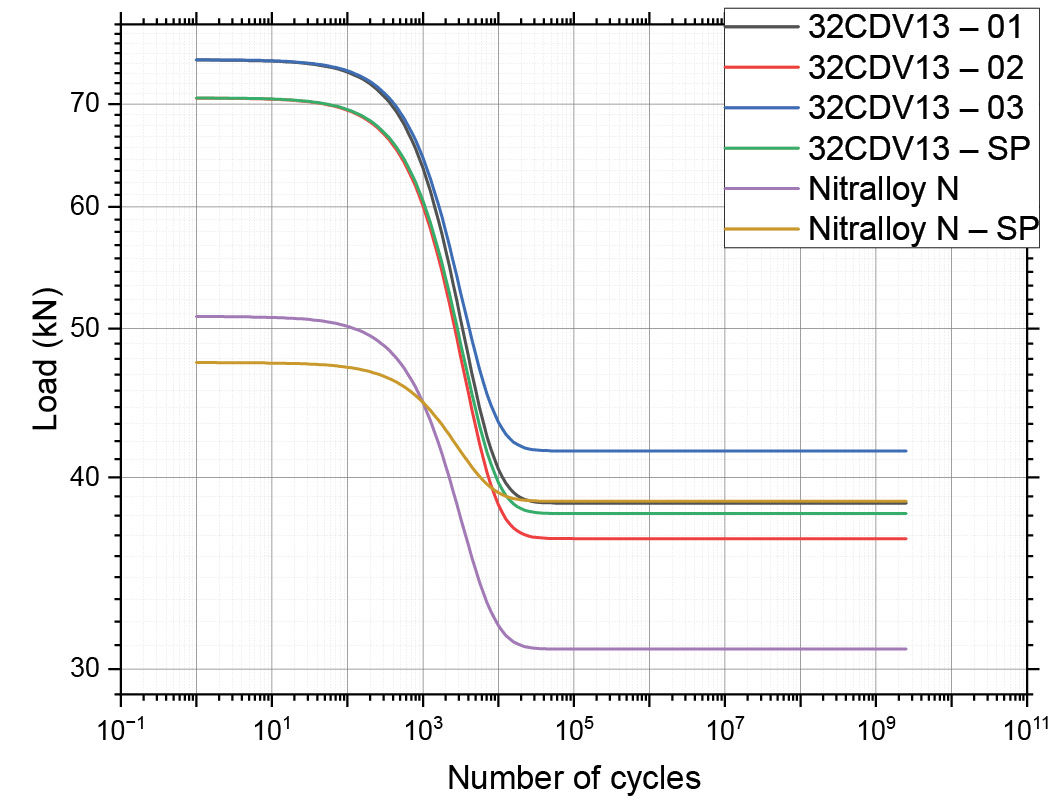

Figure 10—Curves of the tested nitrided gears.

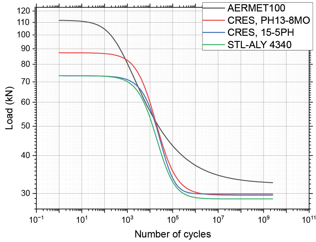

Figure 11—Curves of the tested “other” materials.

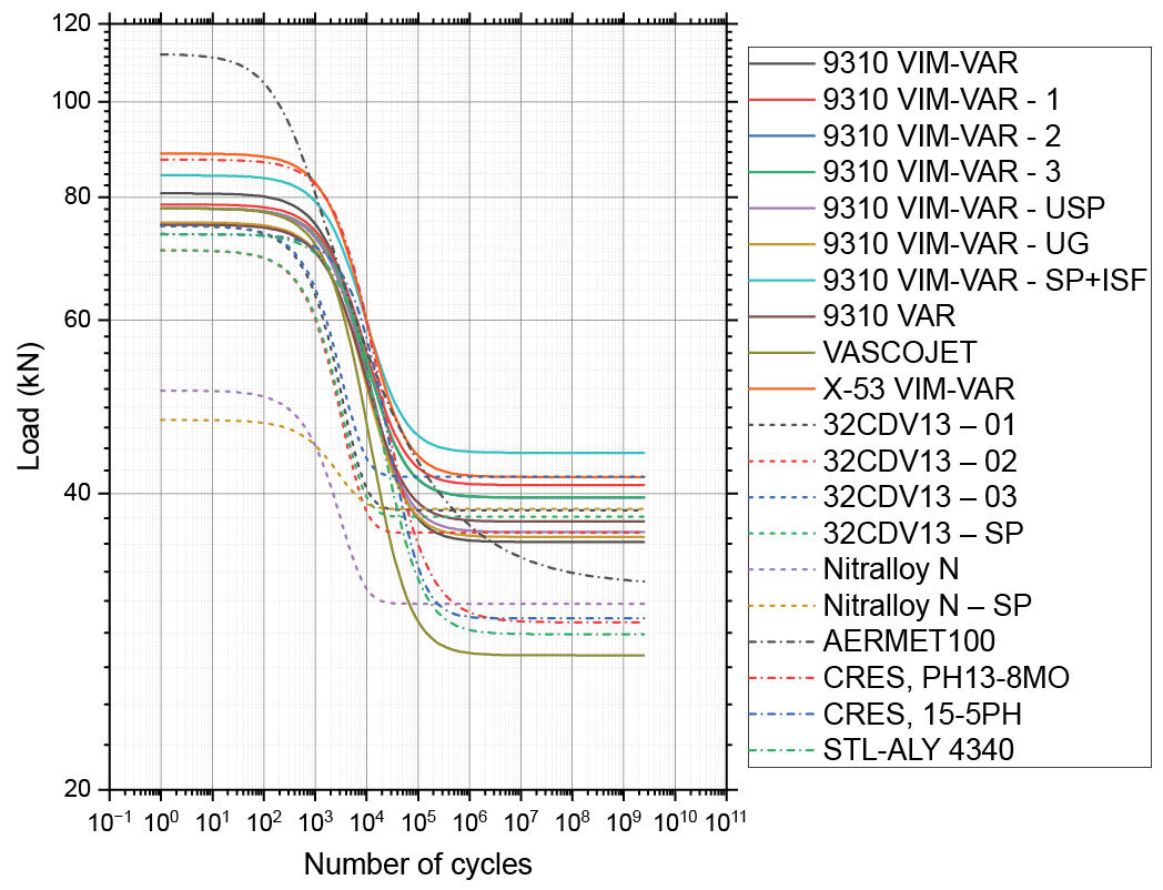

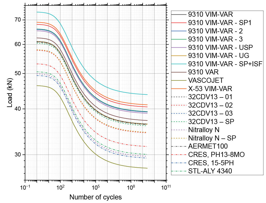

Figure 12—All curves, estimated according to the GEAR05 curve shape.
Figure 13—All curves, estimated according to the GEAR06 curve shape.
Considering the gear material presented here, for case-hardened gears, X-53 VIM-VAR presents higher strength values than 9310 VIM VAR. However, at this moment, the application of Isotropic Superfinishing to shot peened 9310 VIM VAR (i.e., 9310 VIM-VAR – SP+ISF) provides the highest fatigue limit. In any case. tests on the isotropically finished version of X-53 VIM-VAR are currently ongoing. Focusing on nitride gears, 32CDV13 can be considered the most suitable one. Other materials presented here exhibit lower performance and are used for noncritical parts and accessories.
The tooth root grinding is beneficial to the load capacity of the tooth root. This not only reduces the nominal stress at the tooth root (see Table 2) but also improves the surface conditions of the same. In fact, comparing the allowable stress limit for “9310 VIM-VAR – UG” and “9310 VIM-VAR – 1,” higher values are shown by the case with ground root.
Shot peening can significantly improve the root strength, inducing beneficial compressive residual stresses in the surface layer. This surface treatment mitigates the initiation and propagation of fatigue cracks, particularly under high-cycle loading conditions, thereby extending the service life and reliability of critical transmission components. In particular, for nitrided gear teeth, the possibility of increasing the fatigue limit through shot peening has been shown.
The strength values reported here are significantly higher than the values typically proposed by the standards, which are, fittingly, conservative. Such high strength values are achieved thanks to the selection of materials with very high cleanliness. Indeed, the higher the cleanliness, the higher the fatigue strength, as can be seen by comparing the cases of “9310 VAR” and “9310 VIM-VAR.”
It is important to note that the curves presented herein correspond to experimental data obtained from pulsator testing. These results reflect raw test outputs and are not directly applicable to design calculations. Before use in the design process, the data must be appropriately elaborated. A recommended method for such data processing is described in Refs. 13 and 19.
